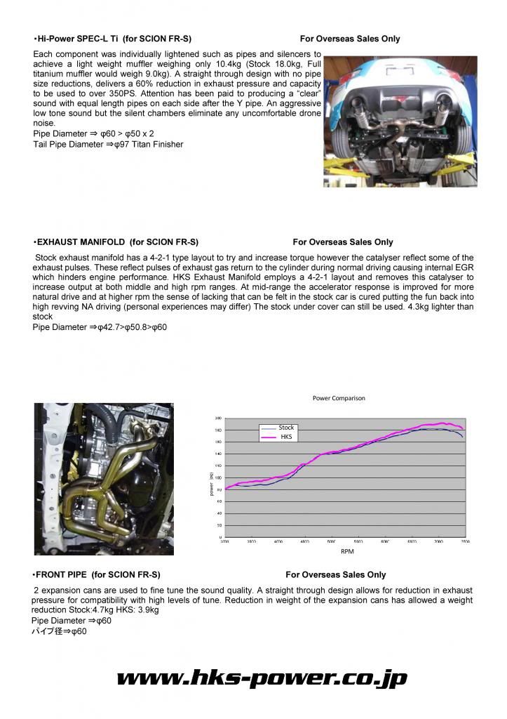

EDIT: Some additional info on the HKS Headers
