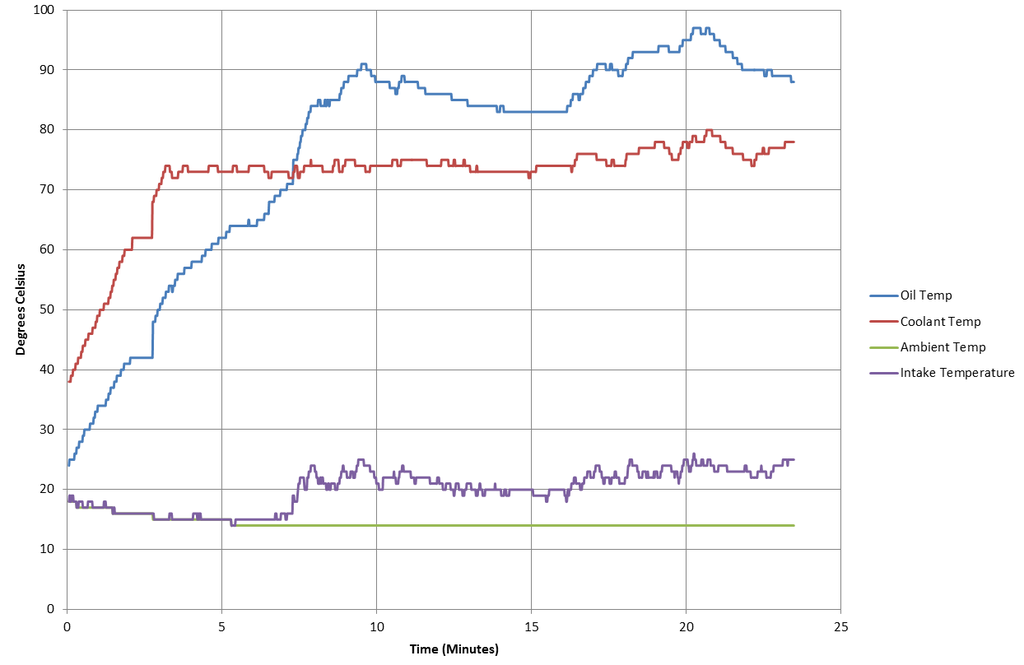

Here's a log of mine. Notice until the oil is warm (I was cruising at 40-60mph) and I started thrashing the car, the IATs pretty much track ambient temps.
ajc209 is offline   Reply With Quote

I would strongly recommend it ! Checked my temps again yesterday in 35C (95F) ambient and intake temps were only 2-4C above ambient . Even after parking for lunch after a run up into the hills I was able to get it back down to around 7C above. Looks like the Perrin cooler blocks the airflow considerably especially with the BRZ which seems to have a smaller front opening than the FRS / Toyota86.

I disconnected my Oil cooler over the weekend. Will get some logs soon, but oil temps looked much better.
