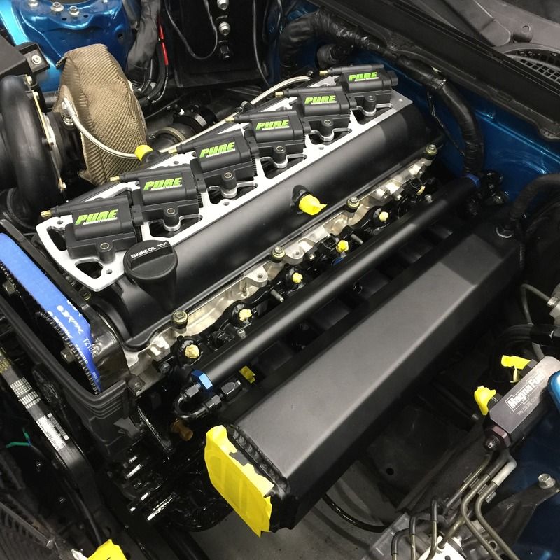

Instead of buying new oem coils and an ignition amplifier, we decided to go all out and do a much stronger ignition solution from induction performance

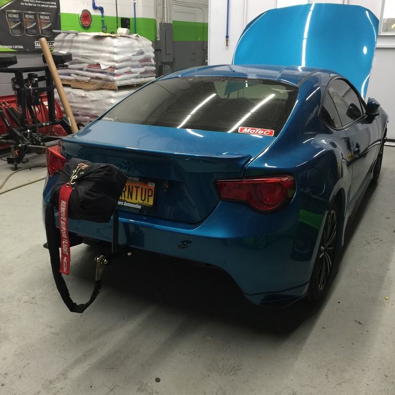

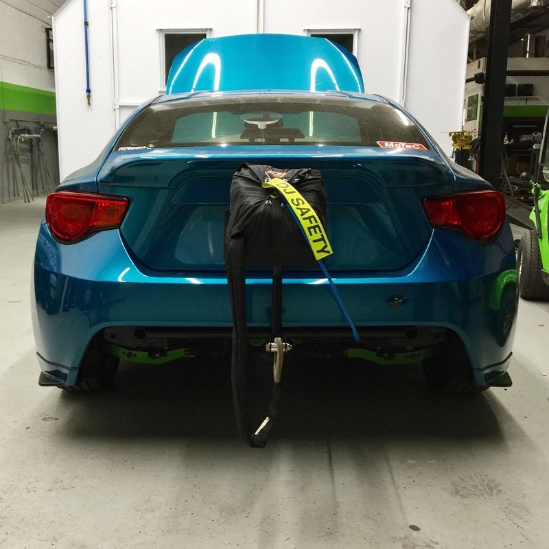

Parachute is done. The whole assembly is removable with one half inch bolt and the receiver sits flush with the bumper. Also have a speed hunters diffuser which I still need to paint satin black before install. Power shut off switch is removable and I have a black rubber plug to seal off the hole for when the car is in full street mode.

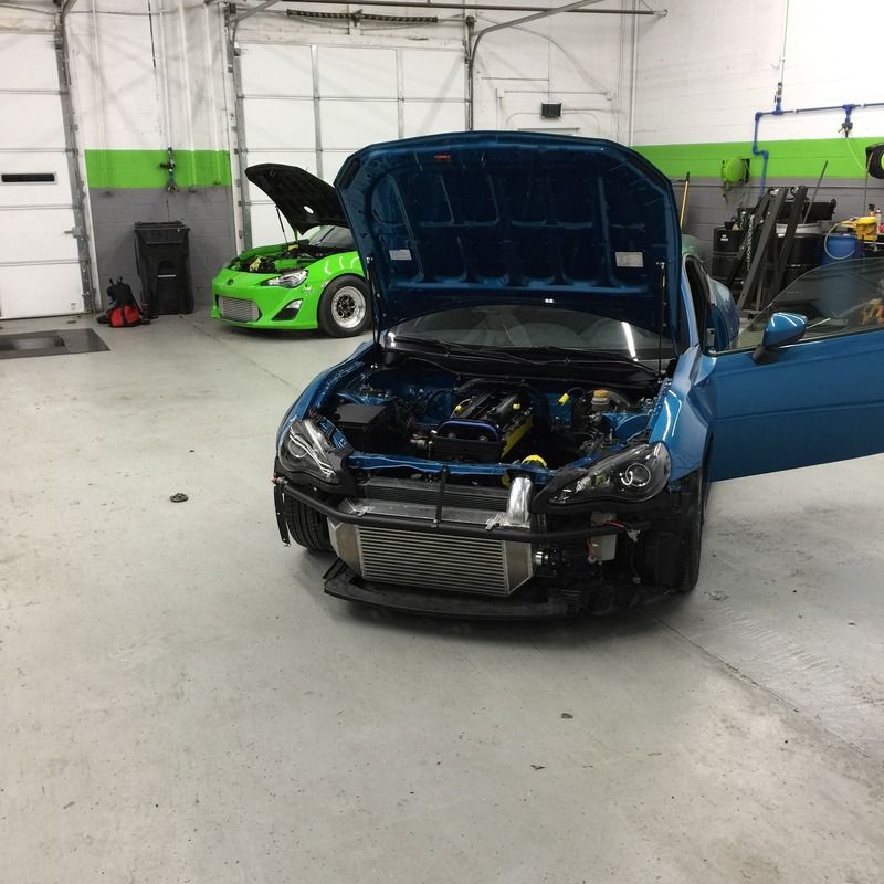

She's in there. Still need to do a little massaging to get the trans to clear, then set the drivetrain angle and weld the trans crossmember in. From there it's all small work.

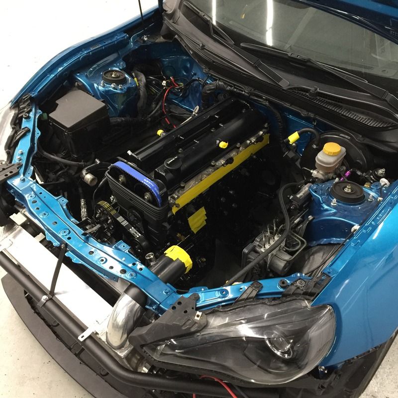

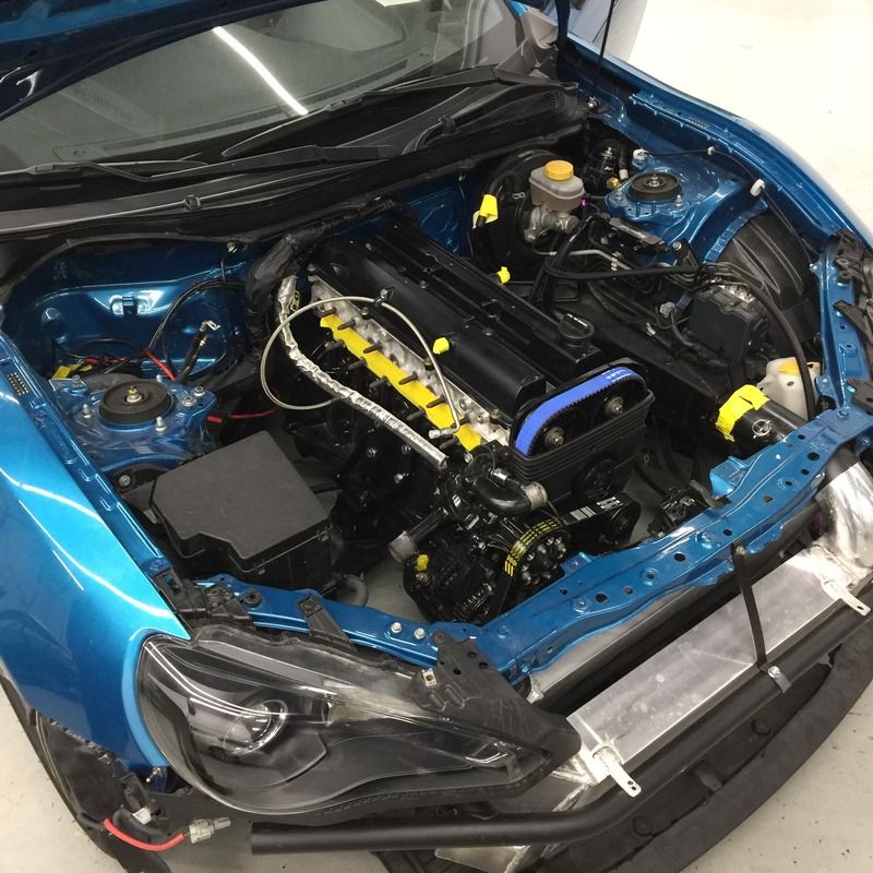

Did some test fitting last night. Intake manifold is powder coated, just need to find time to pick it up. Individual cylinder egt sensors and back pressure sensor bungs are welded onto the exhaust manifold as well. Just need to ceramic coat that and I can start final assembly on those pieces.

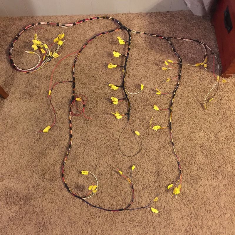

As far as the wiring harness goes, I made my full diagram and pin out and everything is verified. Spools of tefzel wire, connectors and pins are on the way. This harness will be everything I need, nothing that I don't. Routed exactly how I want

Harness is together. Tonight I'll lay it out in the car and trim the excess wiring so everything is a perfect fit. Then I can fully shrink tube, shrink label, crimp terminals and install the connectors

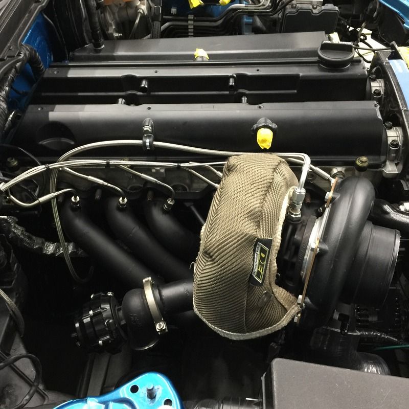

Both manifolds are coated and installed. Individual egt's and turbo manifold back pressure sensor. Just crimping the pins on the engine harness now. Fully shrink wrapped and ready for the ecu end to be pinned by my motec tuner

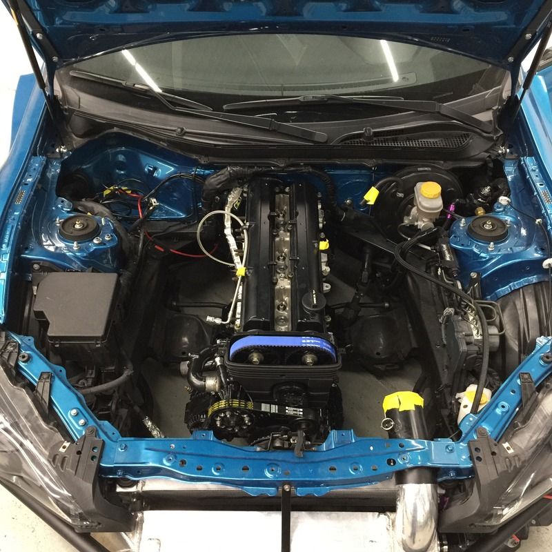

Engine bay is gorgeous, as is the rest of the car!

Mentioned: 27 Post(s)

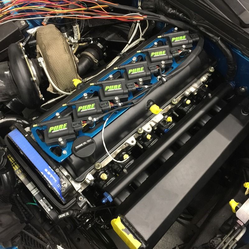

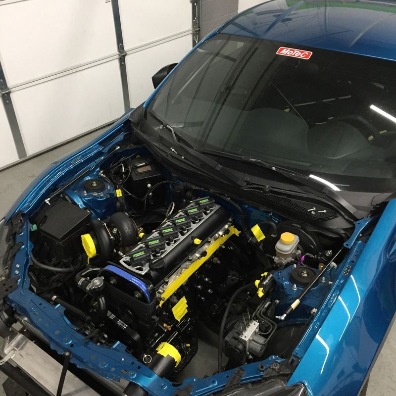

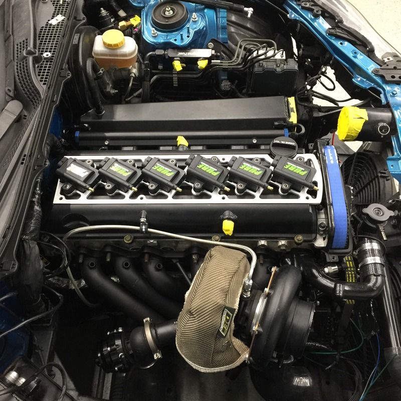

Finished the last of the engine bay wiring today, the coils. All that's left is the ecu connectors, Frs body harness connector, and a couple breakouts for my motec c125 dash, fuel pump/surge tank control, trans brake/bump box control, etc.
An in progress shot of the coil wiring
And the new hotness
