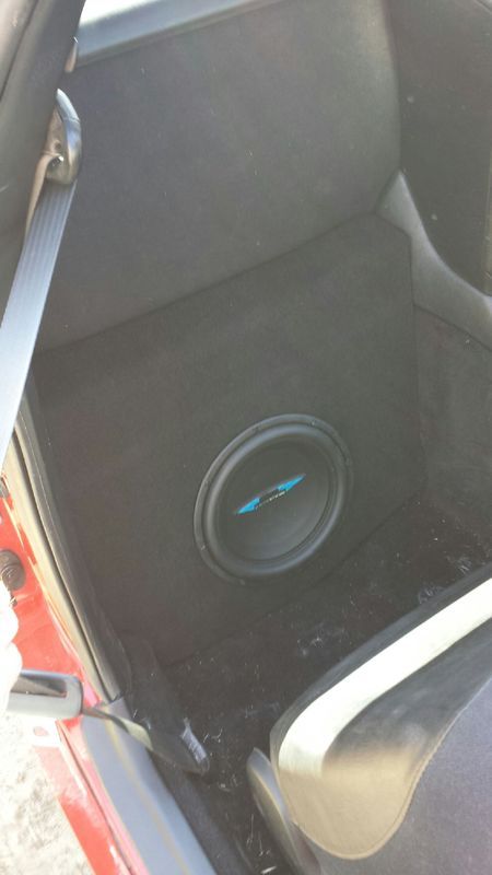

I've been thinking of building a FG enclosure back there since I bought my car in 2012... never got around to it though, as it will be a ridiculous amount of work for an amateur like me.
Now the $2000 estimate I saw several posts back seems extremely excessive. I'd guess somewhere around $1k for a nice one-off custom enclosure for that space. If someone were to plan a GB for them, they'd probably come down to around $600 ea - but shipping would be really high, pushing the overall cost well above what the vast majority would likely be willing pay. On top of that, the enclosures for the trunk area already offered will almost certainly produce noticeably better sound.
I still might build one (after I finish a few other big projects). If/when I do, I will post it up here, and if there is enough demand, I might consider making a mold so that it could be duplicated. I have to admit, I'm not a pro at this sort of thing, so if I made a few, I couldn't promise high-end, show quality results.
Here's a simple FG enclosure I built to squeeze a 10" sub behind the passenger seat my MR2 without losing any passenger seat legroom or adjustability:

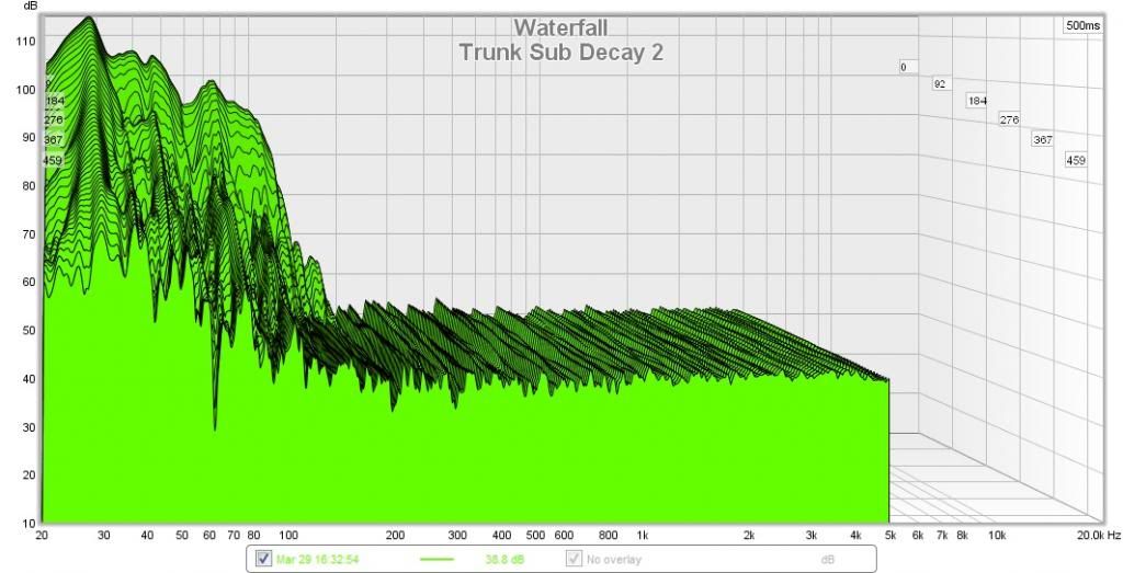

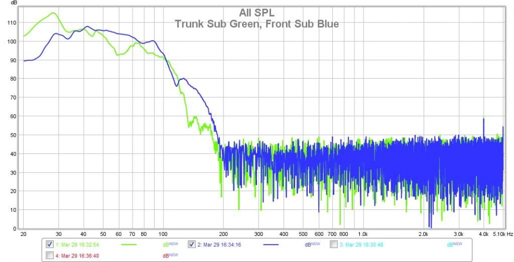

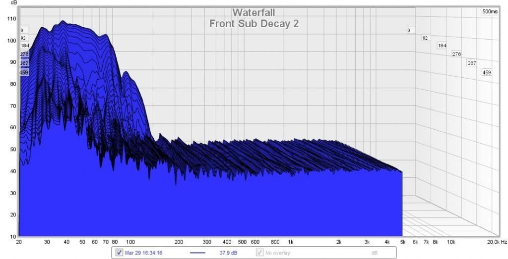

Here are the measurements I promised. This is in a 2014 Kia Optima, but I've noticed similar results in every car I've tried it on, and knowing that a 12" sub can be fit under the glove box in the 86, its very relevant.
This is the measured response of the sub in the trunk corner, and under the glove box in the foot well. As you can see, despite the seat being completely up, the trunk is actually louder. But there is a huge peak of about 8db, at about 28hz. The peak amplitude and frequency will be different in each car, but it will be there. Also notice how ragged the response is, and that it starts to roll off faster than the up front sub. Green is trunk, blue is up front.
But much more telling, is this next set of graphs, the waterfall plots, which show how long it takes for an impulse to decay. Long decay times are THE cause of muddy or "slow" bass. Notice how the up front sub decays much faster than the trunk sub.
Trunk Sub
Front Sub
Listening impressions followed suit. The trunk sub rattled everything, sounded muddy and un-clear. It was louder, but not in a good way. The up front sub by comparison had very few rattles, and was smooth, even with no eq. Individual bass notes were easy to hear.
