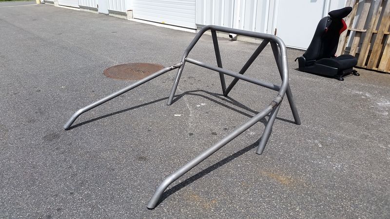

No diagonal in the main hoop down, what's up with the splices in the main hoop to floor tubes, no X or Nascar bars for the doors? There doesn't seem to be something from the main rear hoop coming forward to come down the A pillars, rear down tubes aren't tied into the fender structure with plinth boxes?
Is that even DOM tubing?
EDIT: That's a drag cage, not a road cage, isn't it? But seriously those splices (for no apparent reason) are incredibly suspect.

i too am curious about the metal splice in the middle of the door bar...

The splices are to make the door bars removable for daily use, yes its a street/drag car and yes it is 0.120 DOM tubing fully tig welded. The main structure is welded in while the door bars bolt in and out.
NHRA does not require diagonals at all, the diagonal in the rear and the passenger door bar are more then whats required.
The splices are very beefy interlocking clamps,
http://www.tmrcustoms.com/store/inde...oducts_id=2078
Hold your horses there, the entire cage was built to meet customer requests as well as the rule book, street/strip NHRA approved. Door bars are removable to make it more daily livable.
The rear bars go straight to the floor on the "frame rails" in front of the rear shock mounts. Plinth box's are not necessary in the slightest, they are simply a tool used in cage construction. The box's are collapsed during welding so the cage can be dropped down and the top accessed. The same can be accomplished by punching holes in the floor but thats for full cages, this bar comes out the door so I welded it out side the car. I actually try to avoid plinth box's in my cages as I find they get in the way of seat mounting in small cars and a box at the A pillar gives a nice edge to bang your ankles on.
This roll bar is really straight forward.
I should have been more clear on my application for drag racing and that I requested removable door bars for my daily driving. Spencer Fab does top quality work with premium materials or I wouldn't have used them.
