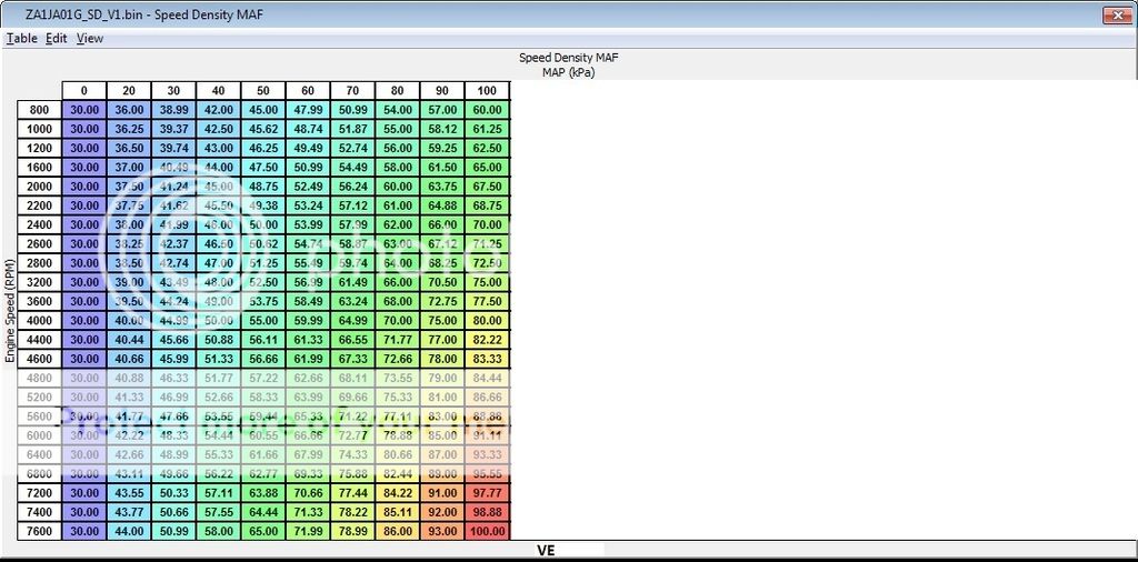

Could be just me but I can't open the zip. Looks like it's corrupt.
"I used a straight RPM/MAP to mass flow conversion table rather than full VE conversion to simplify code."
What do I need to do to convert VE to g/s? I'll most likely do it in excel.
Another question. Is there anything stopping me running full SD? Ie. maf-less.
P.S. love your work. If you haven't seen the Aussie "86 Drivers Club" FB group jump on it. We love tech stuff.

It's not a .zip file - I just couldn't upload a .bin file. Delete the .zip from the end and it's all good.
You'll also need the .xml file additions in posts above, or I can send you my .xml (though it has been modified to how I think) and latest ROM including FlexFuel code.
You don't need any conversion - the table holds a mass flow value in g/s per RPM/MAP cell that gets input into the ECU instead of the MAF flow and the ECU does the conversion to g/rev - you can run full SD if you want, though there is quite a lot of variation at low load/RPM in the final SD value that I'm not sure would run smooth - probably anywhere above 40-60 g/s flow would run well.
If you do go MAFless, let us know how it goes.

I know I don't need a conversion, it's more that I'd like to do it. Rather than explain what I'm trying to do, here's a picture (numbers are garbage):
This seems like a common formula.
VE = (3456 x CFM) / (CID x RPM)
Though it doesn't take into account air temp or baro pressure. There's enough info out there (like this), it's just a matter of me finding the time to implement it.
