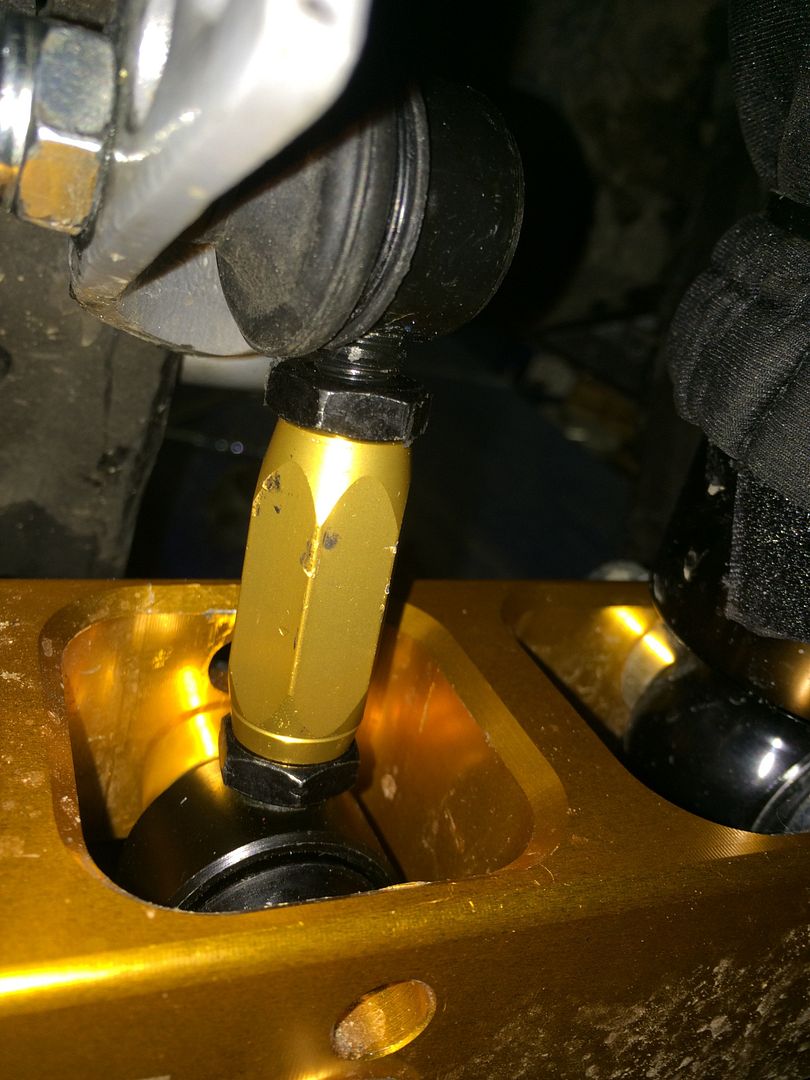

24 March 2015

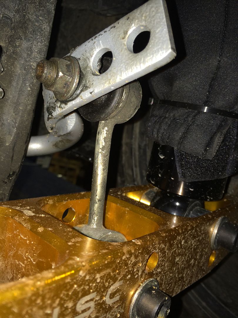

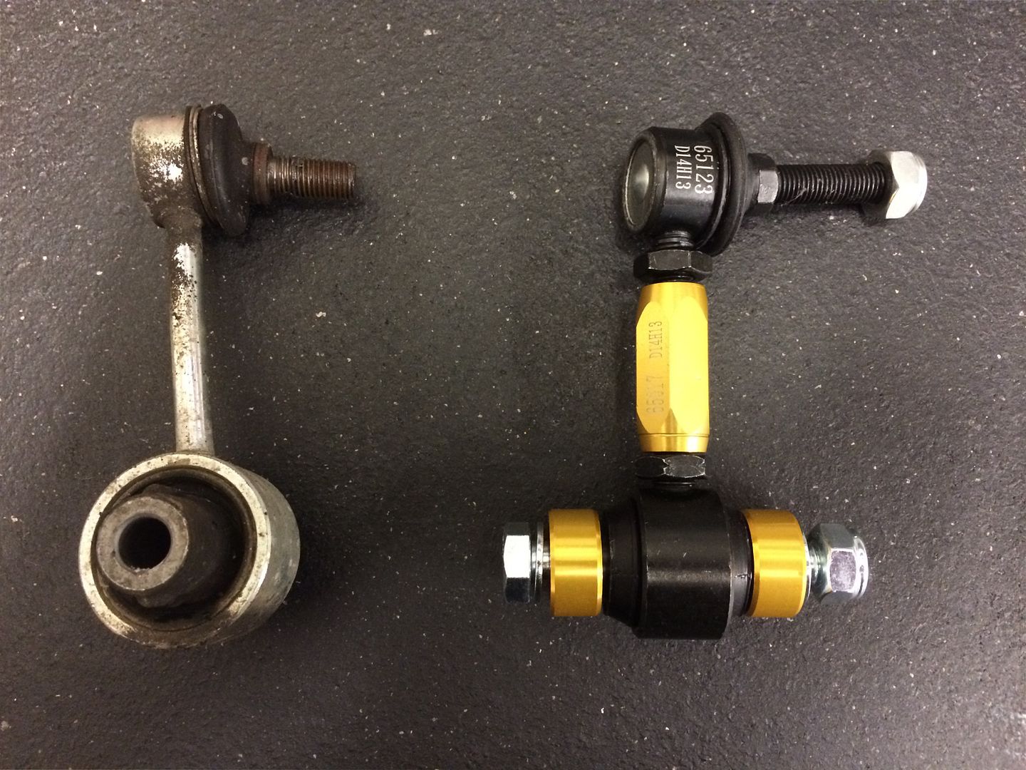

Today we took our BRZ and added some much needed new rear endlinks from Whiteline. I am not sure if anyone else caught it from photos but one of the OEM enlinks were really twisted badly. They made installing new components very difficult, and we decided to just go with a set of Whiteline adjustable enlinks instead. These things are great, they feel super sturdy and are very easy to adjust. Another great product from Whiteline racing, exactly what we have come to expect from them!
Here is a photo of the twisted endlink:
And here is a shot of the endlink side-by-side with the old broken endlinks. As you can see Whiteline's are much beefier and nicer in quality than the old ones.
The installation was smooth and the endlinks look great with our control arms.

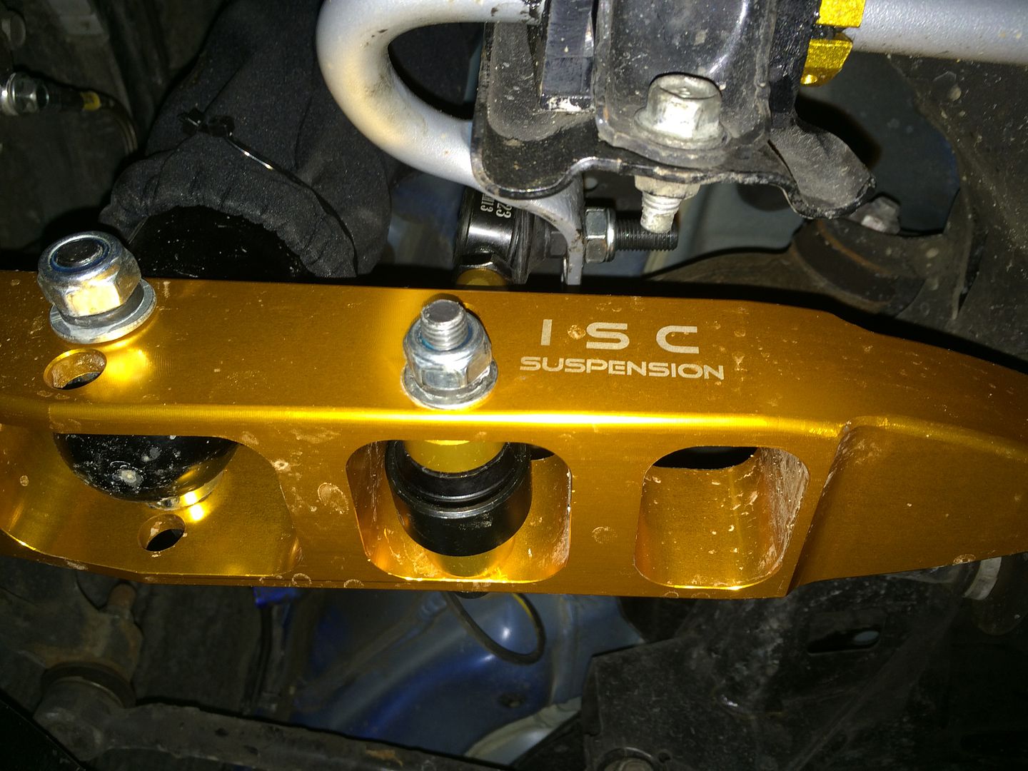

25 March 2015
We also got the chance to add the Whiteline Rear Sway Bar Mount Braces for the BRZ. These mounts are great in keeping the rear end nice and tight.

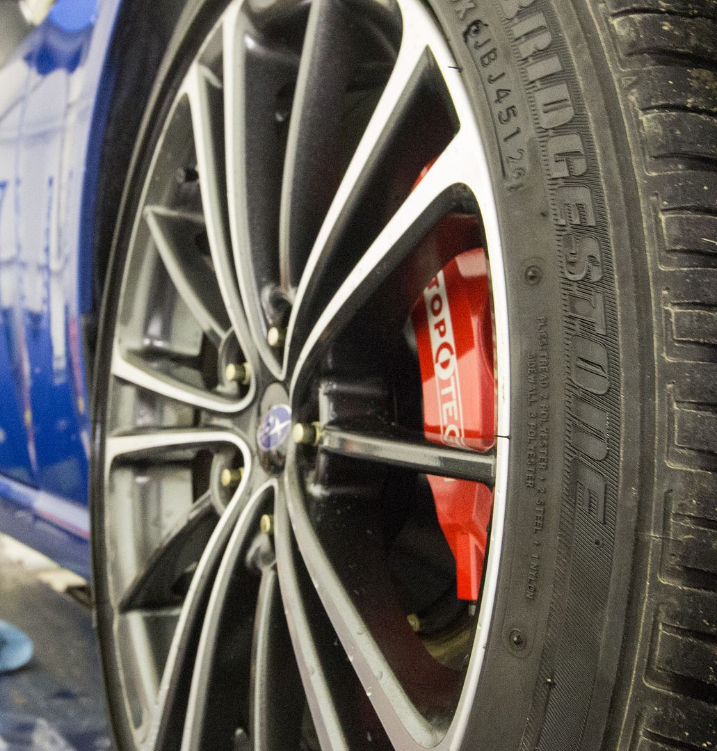

2 April 2015
This week we installed a full set (4 wheels) of our newest product, the extended wheel stud for 1993 Subarus and up! Our Wheel Studs are super strong and very affordable. They also make threading lugnuts on simple thanks to the end that acts as a guide. These, plus our 15mm spacers make for perfect looking fitment on the front of the BRZ with it's stock wheels. You can find these in our store here: ISC Extended Wheel Studs

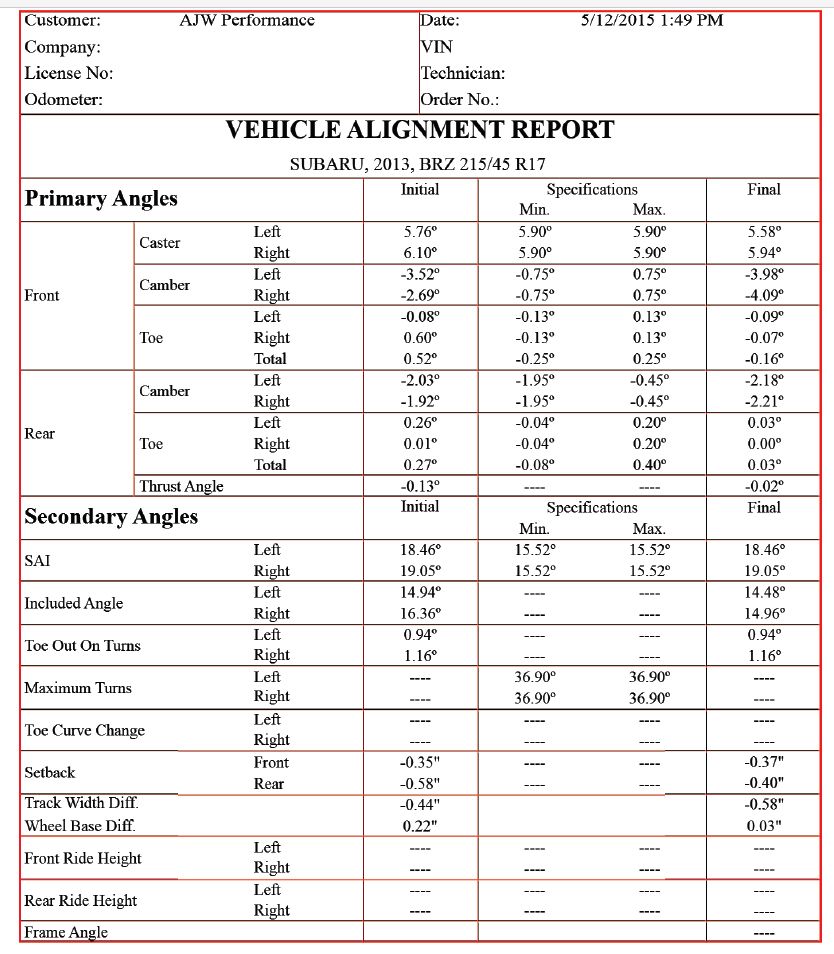

We just got done installing a new crash bar on the front of our BRZ! We also ended up going for a much more aggressive alignment for the upcoming Clubloose Event happening this weekend on May 16th and 17th.
Below are the alignment specs (click the attachment) as well as some photos of the BRZ crash bar. We may be offering this crashbar for sale soon! You will need to cut your fender lines just a bit to utilize it without the bumper, so please keep that in mind!

nice build so far, alignment specs pdf says to have been removed or deleted.

Odd, I could download it but here it is for reference!

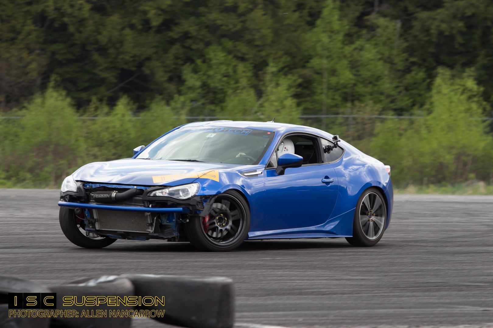

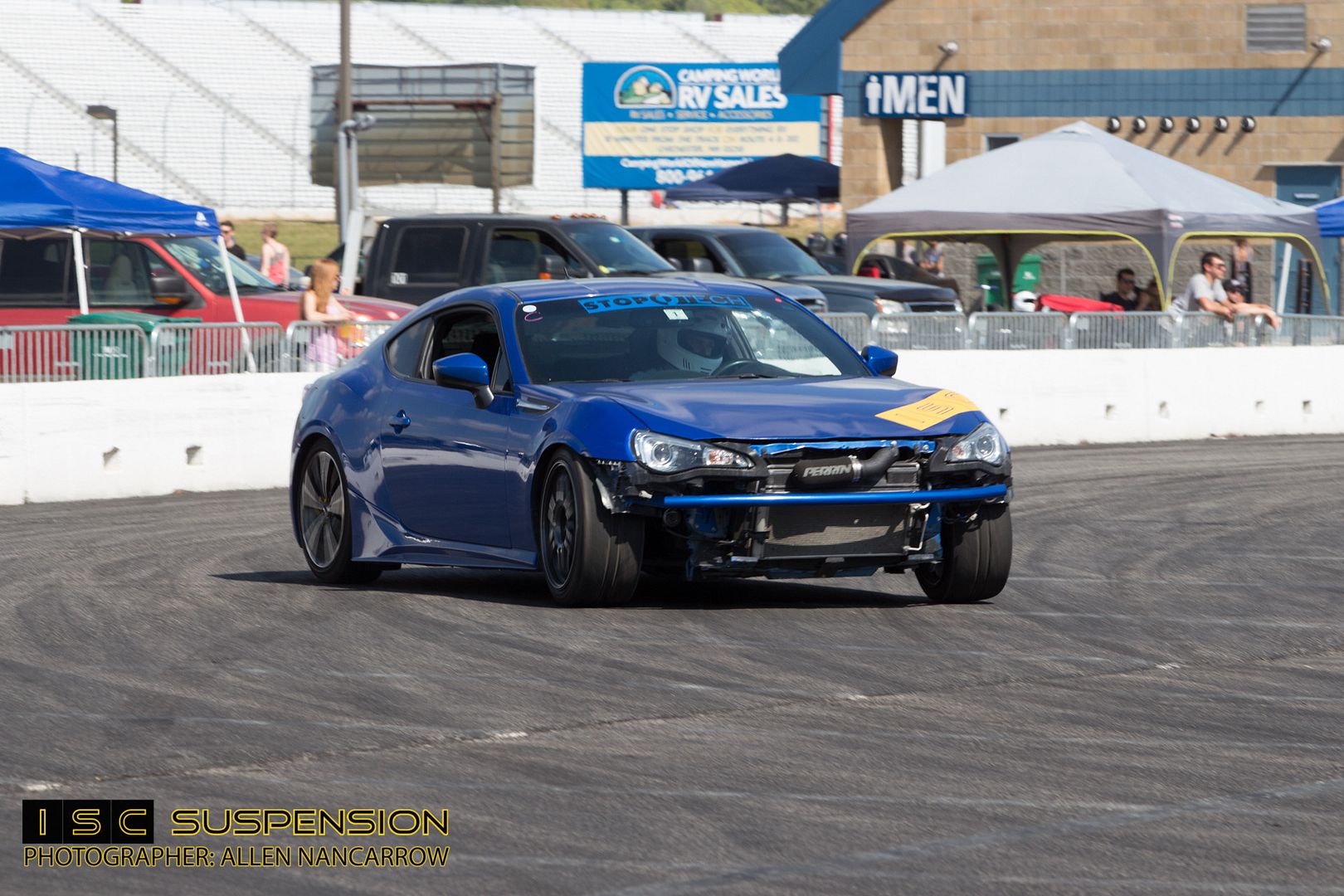

We had a blast this weekend at Club Loose North. We decided to keep the front bumper off and go a little more aggressive this time. We figured if we kissed some tires with the crash bar it would be a little more forgiving Andrew was able to get a lot of seat time and was moved up to B group at the end of the day. Jorel also did a lot of advancement and was lucky enough to get non stop hot laps in the BRZ.
The more aggressive alignment really helped the car. Andrew and Jorel both really learned a lot about line and the best ones to follow at the Clubloose track!
