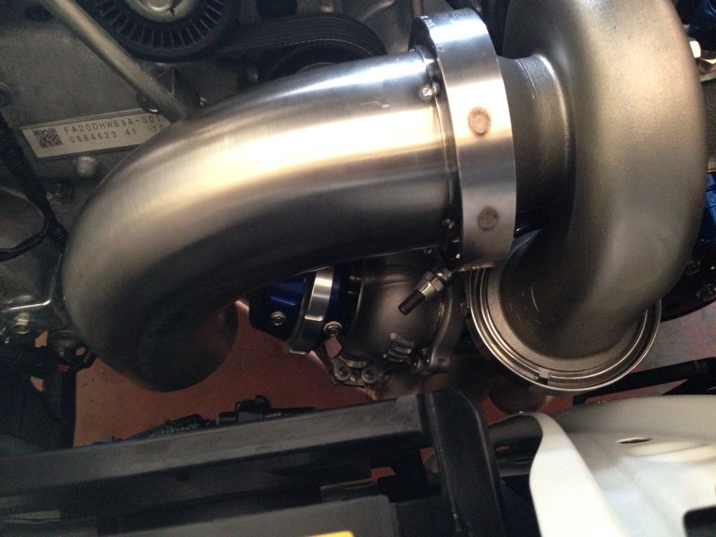

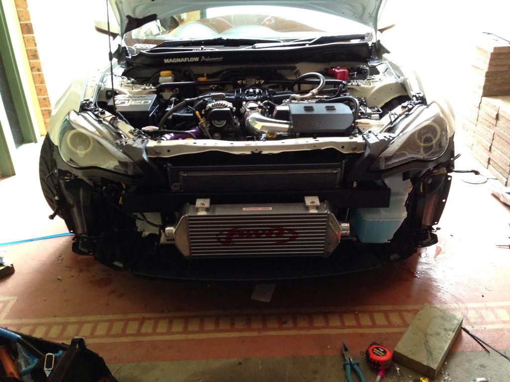

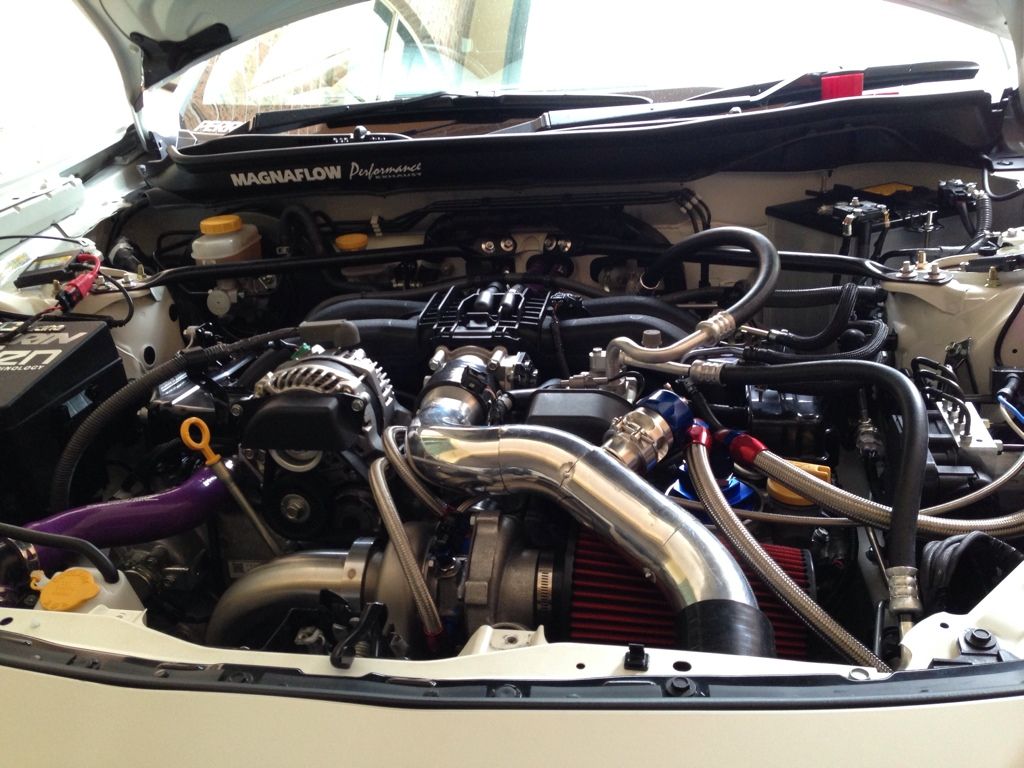

in comes the fun parts :/
instercooler piping with turbosmart Vee port BOV

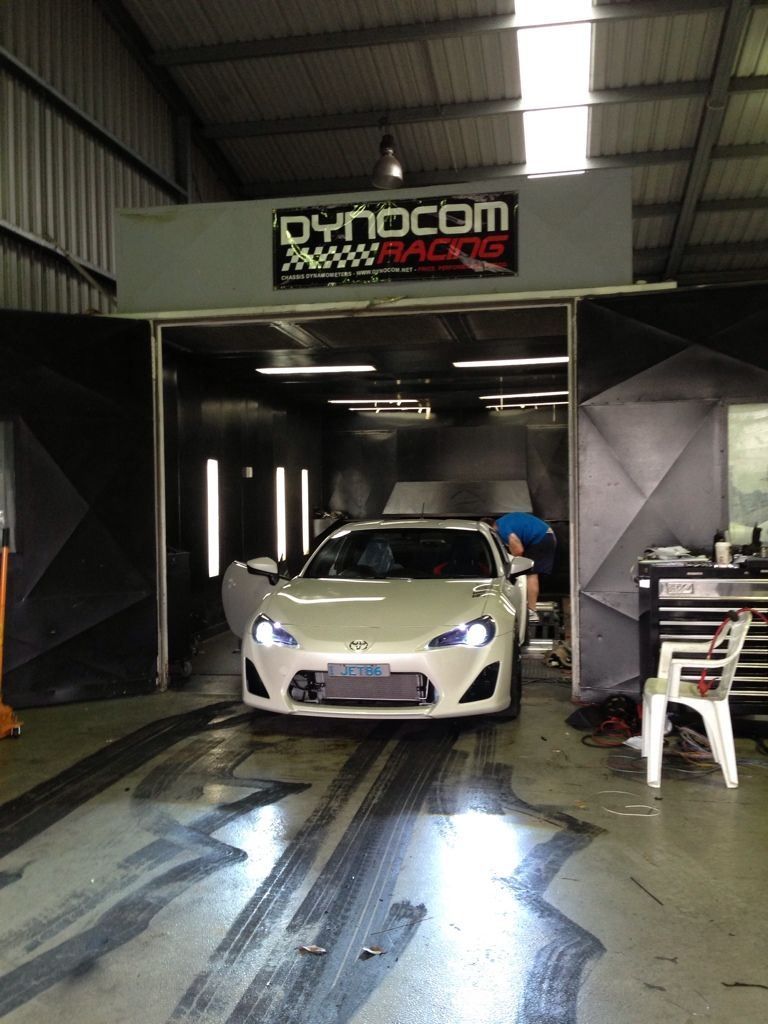

so nearing the completion of the first build (also first in Australia) i decided to take it to the local dyno and see what she put out stock.
Power was 109rwkw

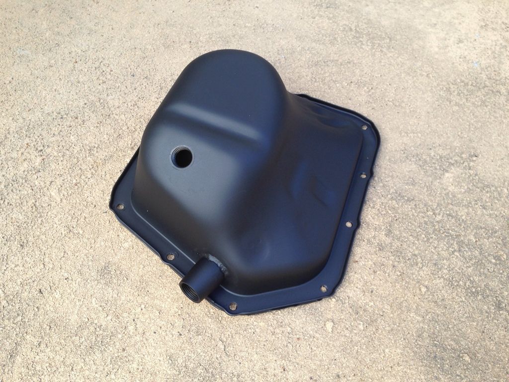

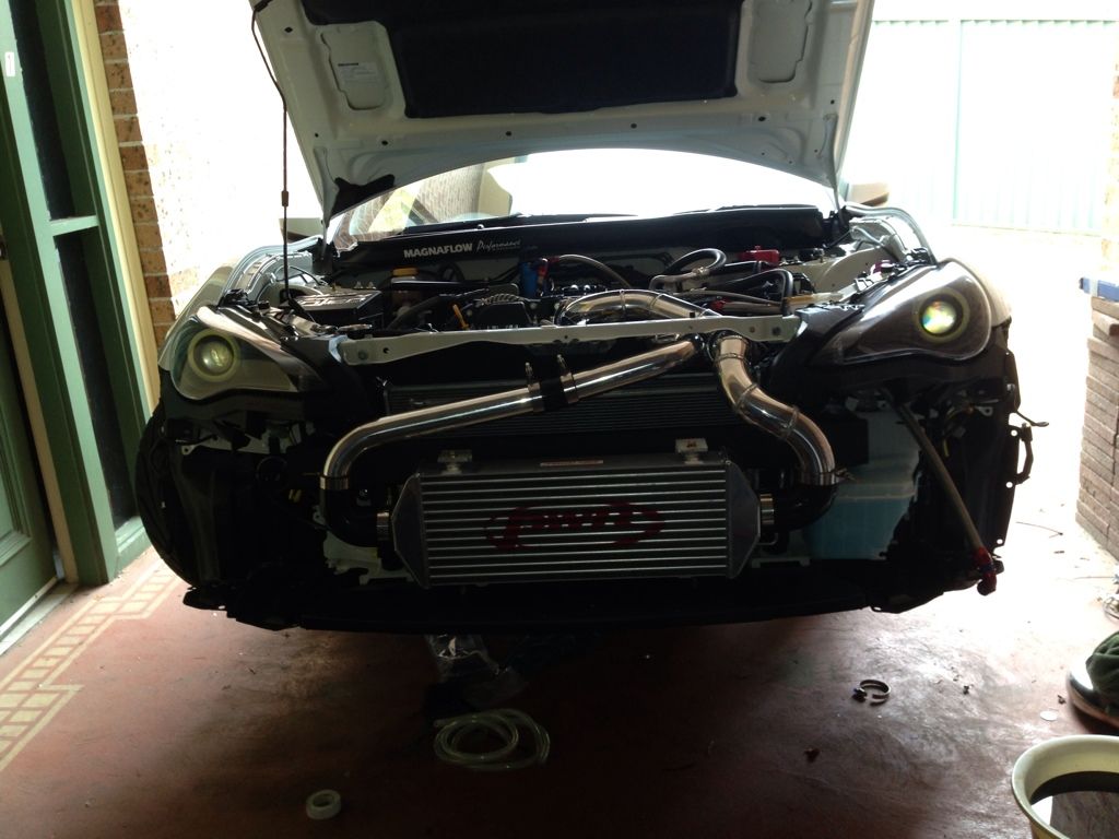

once that bar was set i went back to my little single car garage (actually in front as the garage is full of car parts now) and added the rest of the piping for the intercooler, sourced a PWR intercooler that i could make fit, wrapped the manifold and installed a sump drain plug in the sump.

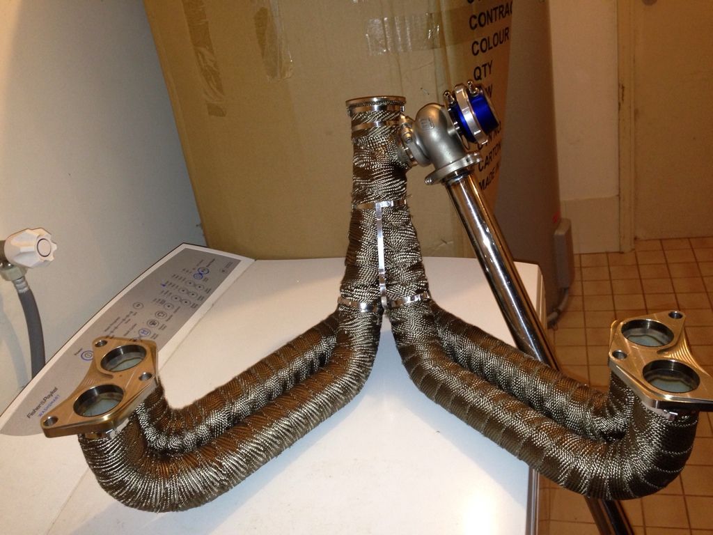

As you can see here, the clearance for the wastegate is tight but sufficient. I just threw a screamer pipe on the wastegate for the time being because #yolo

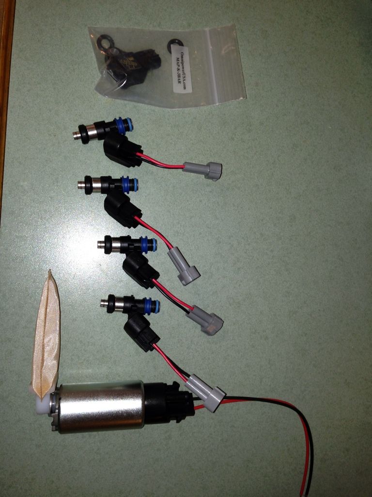

a quick fuel upgrade with some 550cc injectors and a dw65c fuel pump along with a omni 3 bar map sensor to keep things in check

Nice work, that header is beautiful...
lol at the burnouts off the dyno

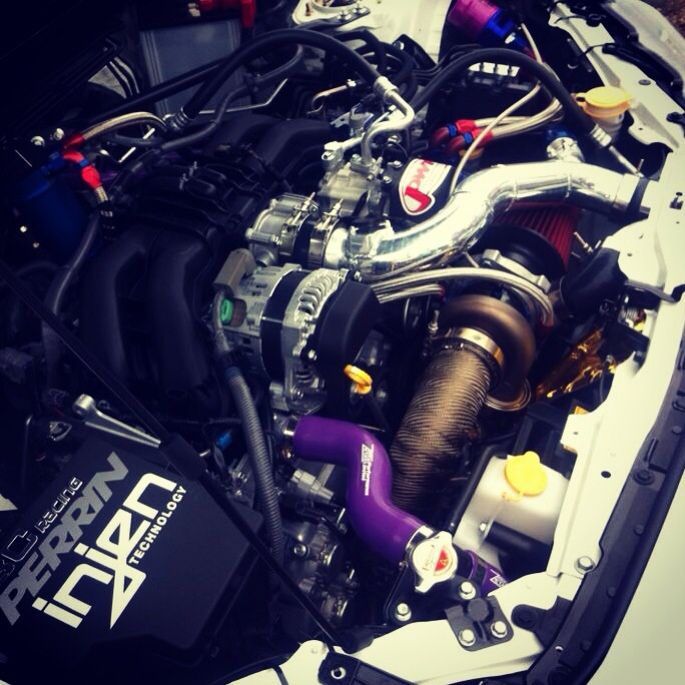

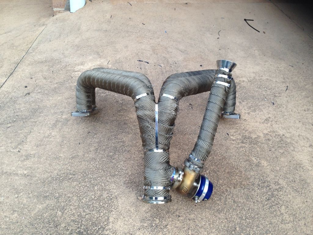

Ok so i finally got the rest of the exhaust done, wrapped the dump pipe and took a quick snap

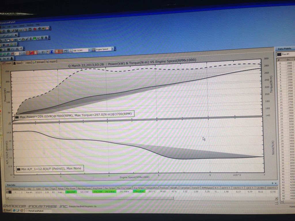

Here's the first dyno run with 6.5psi boost on 98 octane
it was running a bit lean for my liking but still a good result for the first pull on a base map

Posts: 439
Thanks: 84
Thanked 240 Times in 116 Posts

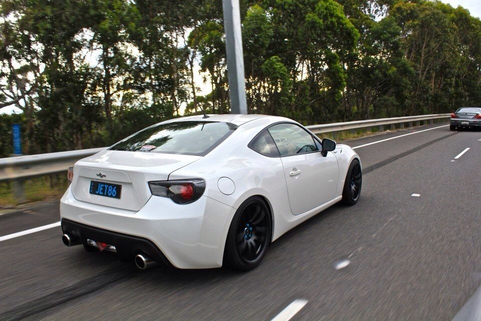

After a few runs we dialed it in and the end result was 211rwkw (282hp) at 8300rpm and 311nm (229ft lb) of torque at 3650rpm on 98 octane and with a stock exhaust system.
the following weekend the anual Megameet was on and i decided to take it down and show it off, response was overwhelming with swarms of crowds surrounding it due to it being one of the only boosted 86/BRZs in Australia.
here is a few pictures of the cruise down to sydney.

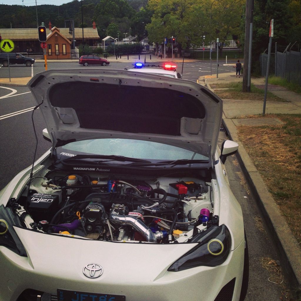

So it had been about 6 months since the turbo kit was completed and word was getting out in the local police department there was a boosted 86 getting around with JET86 plates, it wasn't long until i was being pulled over 100% of the time i seen a cop car as they all now had the automatic licence plate scanners in force with my car being black listed.
After being pulled over 4 times in 3 weeks i decided its time to re-do the whole car as a street legal weapon with full emissions compliant engineers certificate to wave in the laws face.
