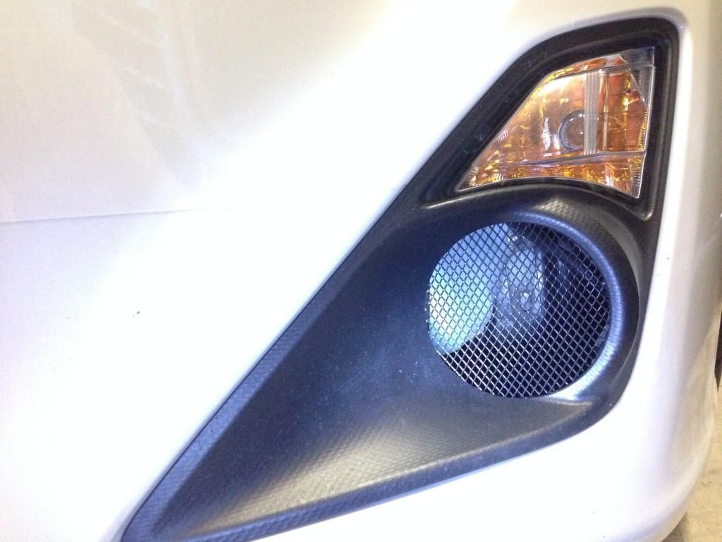

Originally Posted by sw20kosh View Post
Does an oil cooler mounted behind the fog light/turn signal bezel (with a cut-out in the wheel well liner to let air flow out) make you face palm?
Sorta... depends on the application, but generally speaking yes.

Just lurking here as now I have an extra fog light bezel emptied. Passenger side bezel has the oil cooler. Pondering the idea of either 1) move the core to the driver side or 2) how to make use of the driver side as cooling the window washer reservoir is pointless.
