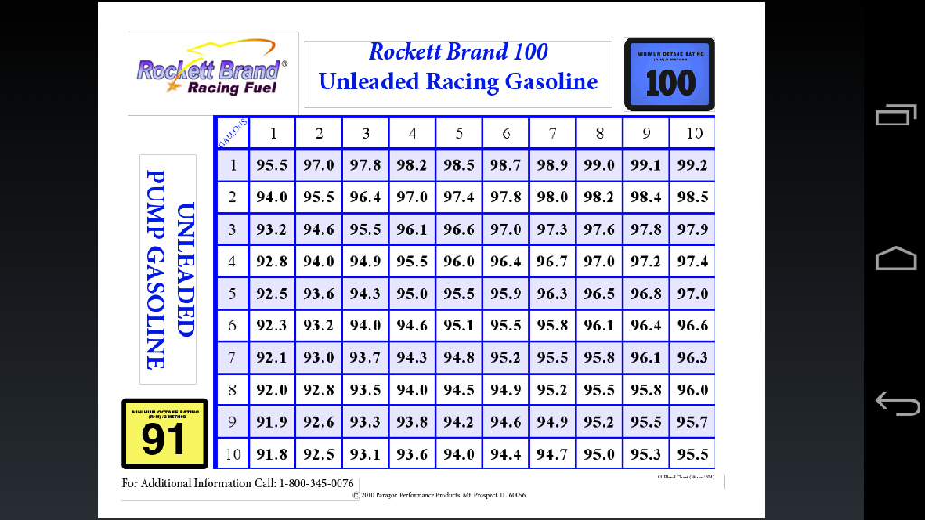

I've also been adding a few gallons of 100 octane to every tank of CrAp 91 octane fuel we get here in Las Vegas. Here's a blending chart if anyone needs it.
