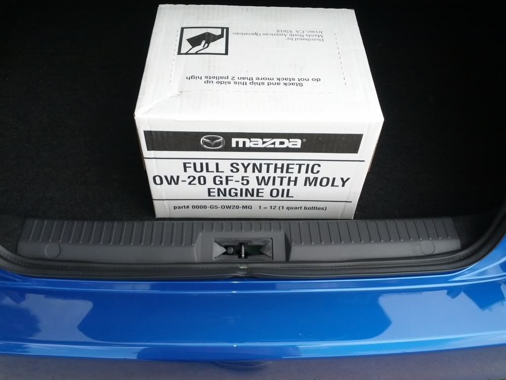

You can use Sustina 0W20, High-Moly Mazda 0W20, or Toyota Genuine 0W20, the three lighest oils on the market, for 5,000 miles, with track days, as a base line. I would have Dyson analyze the oil before going any further. The newest polymers perform amazingly well. They have smaller particle size, better molecular structure and can be used in smaller quantities when the finished product is made. When conducting analysis especially note the HTHS and flash point numbers to ensure that fuel dilution does not prevent you from having adequate viscosity at operating temperature. it is time for people to get over their thin oil anxiety, a driver is only cheating himself out of performance. Clowns will clown. Haters will hate. This is the up to date truth about motor oil. Dennis knows who I am.
This is sound advice. I actually just picked up a case from the local Mazda dealership at $7.00 per quart.
