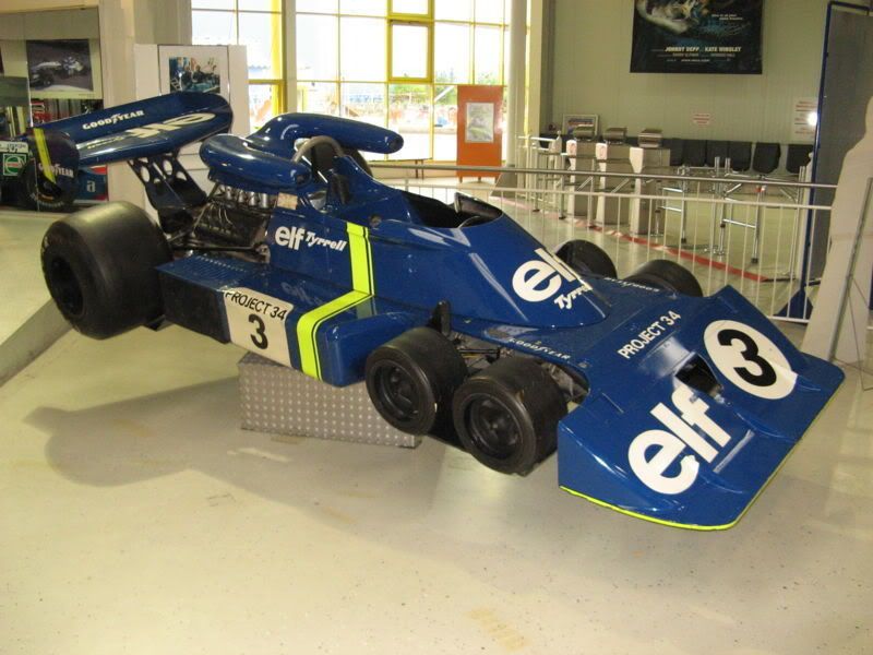

Neither were these cars:

i don't recall the ELF car shown being a flop so much as outlawed...my recollection could be off but....
Remember the Chapparel? they had to come up with new rules to write it out of eligibility because they were using jet engines to create under car suction that allowed ridiculous cornering speeds...
Lots of stuff happens and isn't well accepted by sanctioning bodies and other teams, but calling something short lived a flop is usually wrong, if it didn't work well it would usually evolve for a bit before disappearing, most single showing cars are outlawed, often only because of the potential, before they even work well enough to be advantageous.
