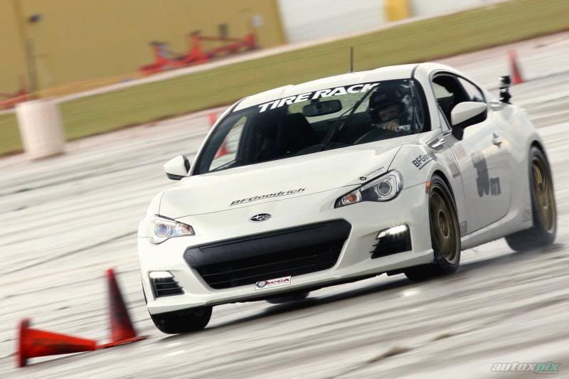

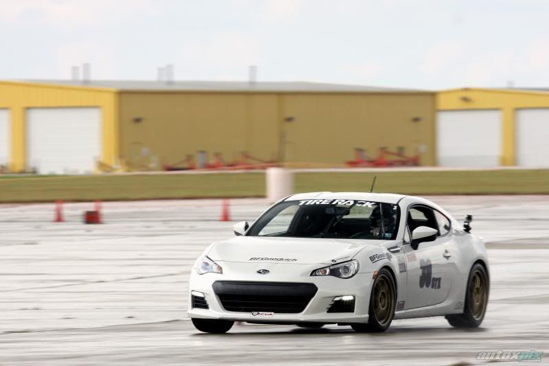

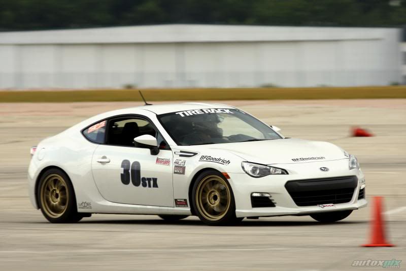

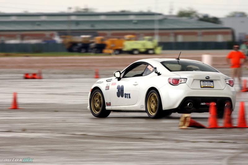

Pics from the Wilmington National Tour.
Credit autoxpix.com
