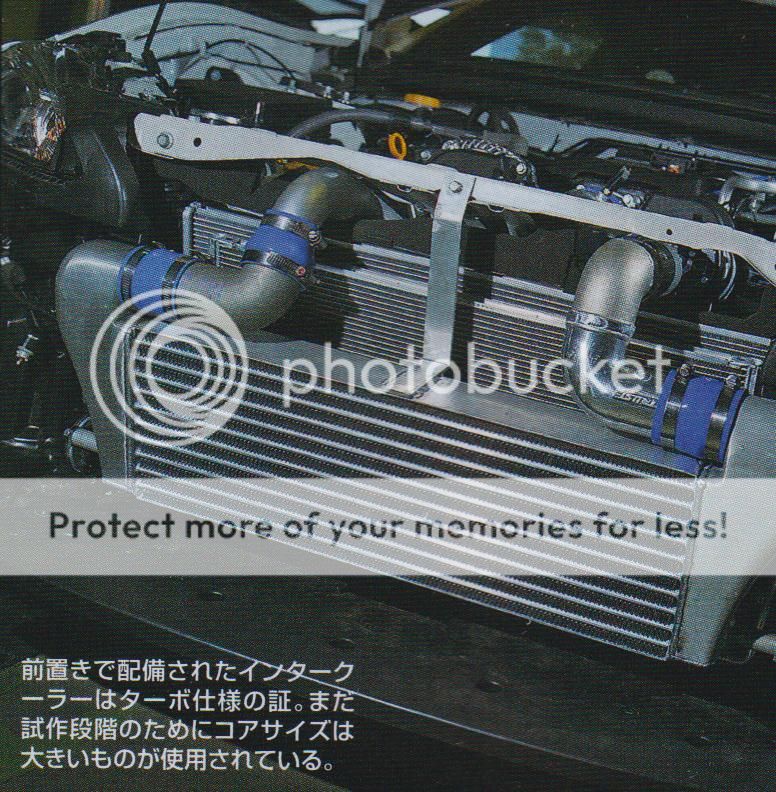

Smile Larger "Custom" Intercooler?
Any word if the larger core will be available as a kit, or add on? I am sure I could have something fab'd up, but I wanted to see if we could keep things off the shelf.
Also does this core/piping work with the front (or jdm) crash beam? I quoted the core picture below.

^No crash beam in that picture. The intercooler and the elbows on top of it are right in the place that the crash beam normally sits iirc.
Hard to believe that Greddy would design a setup that compromises the factory beam--Hmmm...
Why? This wouldn't be the first one.
Why?
Compromised engineering for street car applications, maybe?

My shop had to hack my gsr crash beam to fit the larger greddy fmic back in the day.
I meant why is it hard to believe, considering that they've done this several times before. It's pretty common in this world to have to hack up or remove a crash beam to install a FMIC.
For a track car yes, for a street car, it is extremely dumb to do this. Cars are a weapon that can kill us in an instant, not to mention that without bumper beam any frontal crash at 20+ mph will very likely total your car. If you like your car and yourself, don't do this to your street car.
Clearly, but that's a complete aside from what I'm talking about. Someone was having a hard time believing Greddy would design a system that doesn't work with a 100% stock crash beam. As if Greddy was some unicorn tuner company that designs race systems for the race track only (it's a tuner kit after all) that don't compromise street cars in any way.

Hey guys, just wanted to chime in in regards to the intercooler and crash beam.
The kit will allow you to use the crash beam, but you gotta cut some parts of it.
I will post pics later but if you look closely at the pics in page 1, there are two types of intercoolers. The final production model will be the one with the couplers pointing up (smaller in size).
