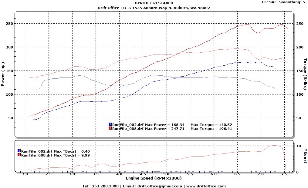

Silly hiccup at 6800rpm, not really sure why but we are working to fix it. Still happy with 250whp at 6500rpms.

That hiccup I've seen in 4 different dynos now with the vortech kit. If you figure it out please post. Curious if it's just a tuning item, install issue, or something else

It's not vortech specific. The HKS has it too.

http://www.ft86club.com/forums/showt...t=37729&page=2
HKS with the same oddity. The only thing I can see from my logs is a timing pull.
