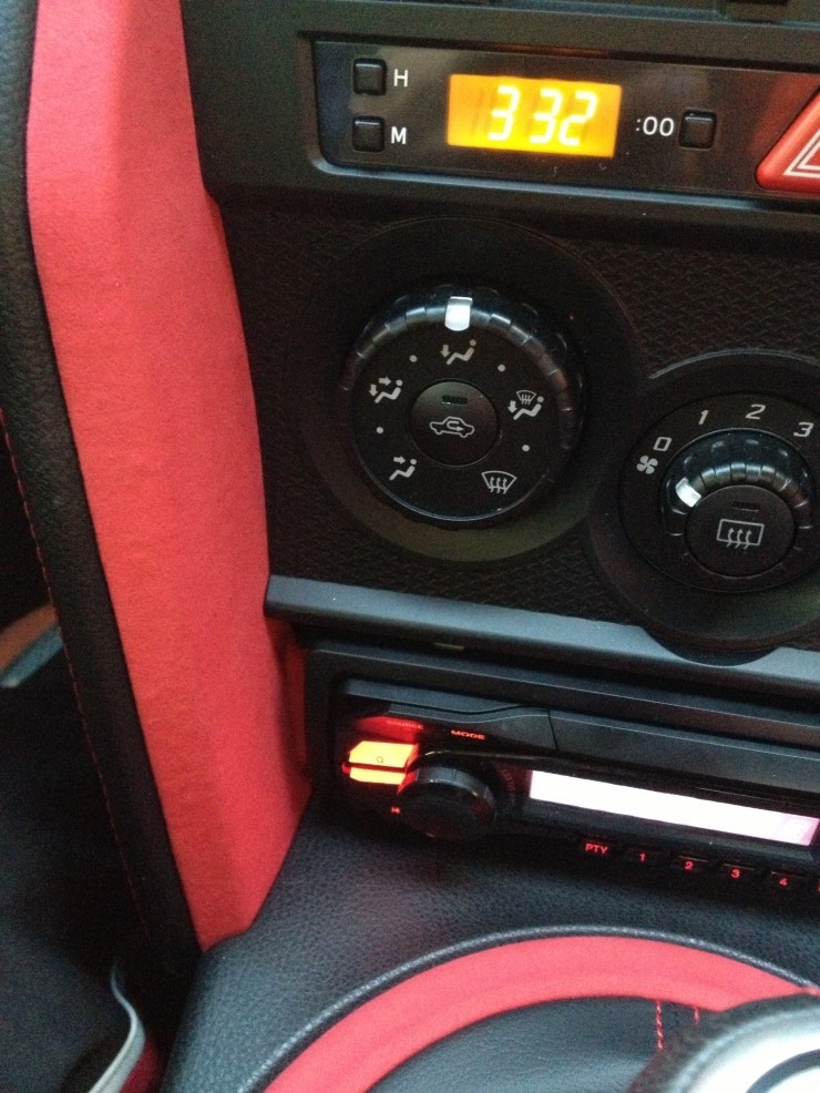

Do you have any pictures of how you made the bottom 1/2 din?
x2! I want to run my single din for the SQ but want the tablet + torque. This would be perfect aside from ... can you get CDs in without hitting the shifter?

CD problem
I use iphone for music source. so CD inserting was not my priority.
when shiter is in 1,3,5,or neutral , cant' CD in . but shiter is in 2,4,6 u can use CD.
Perfect! I don't use CDs often but at the very least being able to is a huge thing, even if it involves moving the shifter down to do it, thats good enough for me!

actually . lower place is very small. & real problem is that some strong steel
frame(?) is blocking inside . So if you want normal size 1 din receiver , you must cut that off. that one of above picture is normal size receicer so I cut some steell inside. It was very very very painful job.. car & my heart is hurting... =(. I can't recommend this style.
BTW there is Small size( 3/5 size depth) media receiver from SONY.. DSX-A30 ( it is asian name, I dont know it is available in USA ). & someone of my country
use A30 for lower place install. & He said that was piece of cake, no need to cut anything. like bolt on. ..
but it's media receiver so you can't use CD .
sorry for bad english =). I hope this helpful
