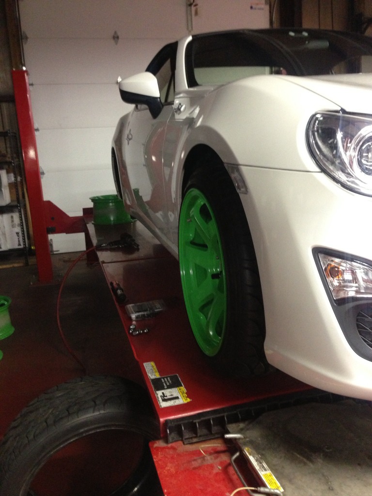

Why dont those look like they are poking alot more? 29/24 offset?

How do you feel the car with those wheels? It is slowly or is the same?
Similar

Originally Posted by PradiG View Post
The poke in post 1 looks closer to what i was expecting but i dont see offsets (i have 9.5 +38 so i thought the 9 +2x should poke about the same as mine do but in the pics they dont appear to, thats why i asked)
Attachment 37560
9.5 +38 will have the same poke as a 9 +33.
Mathematically a 9.5 +38 would be equal to a 9 +31.65
I understand that, my point is, i have a 9.5 +38, so my question was why does it appear that a 9 +2x appears to poke LESS when it should poke MORE than mine do
Maybe its the color/lip, anyways... Was just curious

Front and rear are poking. Its just the angle and color or the car that made the wheels look flush.

Probably because of the 235/40 or 225/40 tires which makes it look flushed
I got 9 +34.5 to be the same as 9.5 +38...
edit: my calc is wrong...
