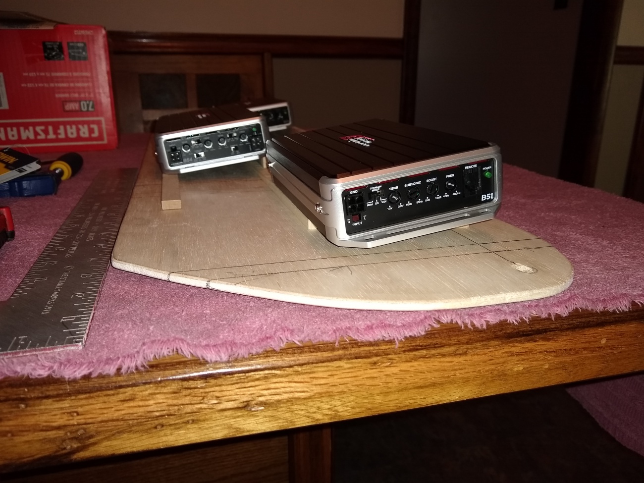

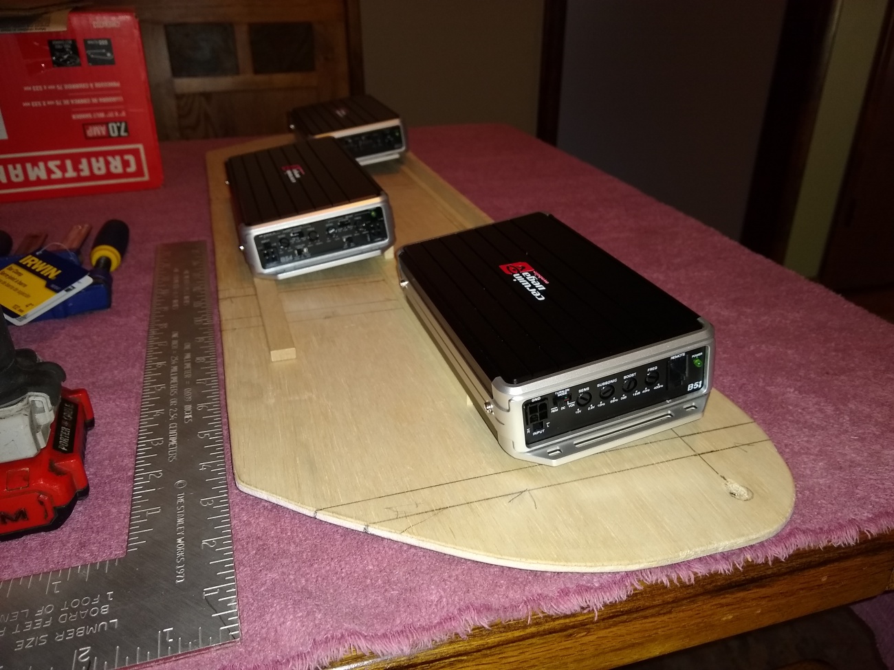

Amp placements.
I've decided that I'm going to
mount them at an angle to make
it easier to make adjustments
on the ends, and also so that I
can have lighting underneath
each one.
