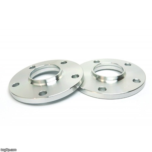

Some thoughts about spacers (in no particular order)
IDK for sure, but the thinnest spacer to have an extended hub I could find was a 10mm 5x100 56.1mm spacer. (similar to pictured below)
The 5mm spacer I had took up all but the very tip of he hub and didn't provide the wheel quite enough to feel like it was positively centered as with the thicker style spacers that I replaced them with. Not to say I had any issues with them, they worked fine for the few days I ran them.
Spacers are made in several different outside diameters. The first set I purchased looked like the ones you linked. When I installed them, the spacer was a bit bigger than the brake rotor hub. They looked terrible.
Then I searched "12mm hubcentric 5x100 56.1mm spacer". I found these.
After installing extended studs all around...
These slip-on spacers worked great and are the same diameter as the center of the brake rotor. And being as they have a 56.1mm center hub; they firmly seat on the hub of the car and provide a solid center hub for the wheel.
I also have used a set of bolt on style spacers. I liked them and they worked good. But, with 10 lug nuts per wheel (more stuff to worry about) And the (minor) difficulty of having my wife sit in the car and press the brake while I tightened the first set of lug nuts on the spacer. I feel that if you can use slip style spacers and extended studs; they are better.
The only reason, IMO, to have 10 holes in a spacer is: bolt on style spacers that allow the studs to go through and "sit" in the recessed pockets of a wheel.

Thanks for the experience. Very detailed and real life. One other thought I have about hub centric is that maybe it is not just 'centric'? I think it is quite dangerous for the lug nuts/studs to be responsible for bearing the weight all the time. The majority of the job of bearing the weight must be done by the hub, right? So a thin hub centric lip might be good enough to center the wheel, but it won't be able to carry the load all the time.

What is bearing weight is very high friction between wheel hub & wheel disk. Properly tightened wheel nuts just press strong enough wheel to hub to ensure that friction, they don't carry themselves any sideload/weights (unless they get undone ).
As for "centric" part, it's more about how you get wheel centered when bolting on, to not get wheel bolted off-center/eccentric. Be it via same sized wheel center bore & axle size (or +some spacers with flanges), to make "hub-centric", where it doesn't matter much what shape bolt/nut flanges are and even flat, as stock on some brand cars, may work, or it's "lug-centric", where lug-nut holes in wheel disk and lugnuts are of specific shape, that wheel centers as you tighten them (in proper, star, fashion). In this category are for example our wheels/lugnuts of conical 60deg taper flanges. Ball shaped seats should act in similar fashion.

Hub centric is convenience factor for mounting the wheel, the studs/lugs take ALL the load on every modern car.
https://949racing.com/Hub_Centering_Ring_FAQ.aspx
I've had a 5mm slip on spacer on my car for like three years, over 30k miles, arp studs and gorilla lugs, torque properly, don't slide the wheel on the threads of the studs and life should be golden. This reminds me that I should spend some time cleaning my studs next time I swap wheels.
