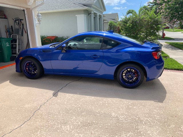

Just finished up a 750 mile round trip to pick up some tires and wheels I bought in Jupiter Florida. 17x9+40 Konig Hypergrams with Bridgestone RE71RS tires. The whole trip, I couldn't believe how responsive the supercharger was going down the highway. As advertised there were some scuffs on one of the wheels, a blue Sharpie covered that up easily that the casual observer would never notice. Going to cars and coffee meet in the morning and autocross with Red Hills Region SCCA on Sunday.
