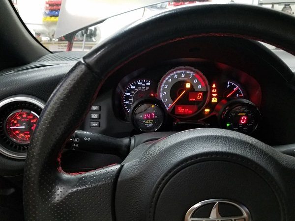

Thanks! Getting pretty close. I got the aem aft gauge but wasn’t really sure how to wire it up to the ecu for tuning. But then after asking on another fourm. People said the aem anaolog sensor is crap and not worth connecting to the ecu for tuning. Rather I’m going to use the stock wideband sensor for the tune and just use my gauge installed so I can monitor the afr easily. I sent Delisious tuning an email asking what they would prefer to tune with but havent heard back... Clutch is all installed and I think just the Aos system is left before tuning. What’s the advantage/disadvantage to a custom dyno tune?

Gauges are in.

Did DT ever get back to you about the use of AEM’s sensor? I’m about to buy their failsafe gauge.
Yup; you can read hear
