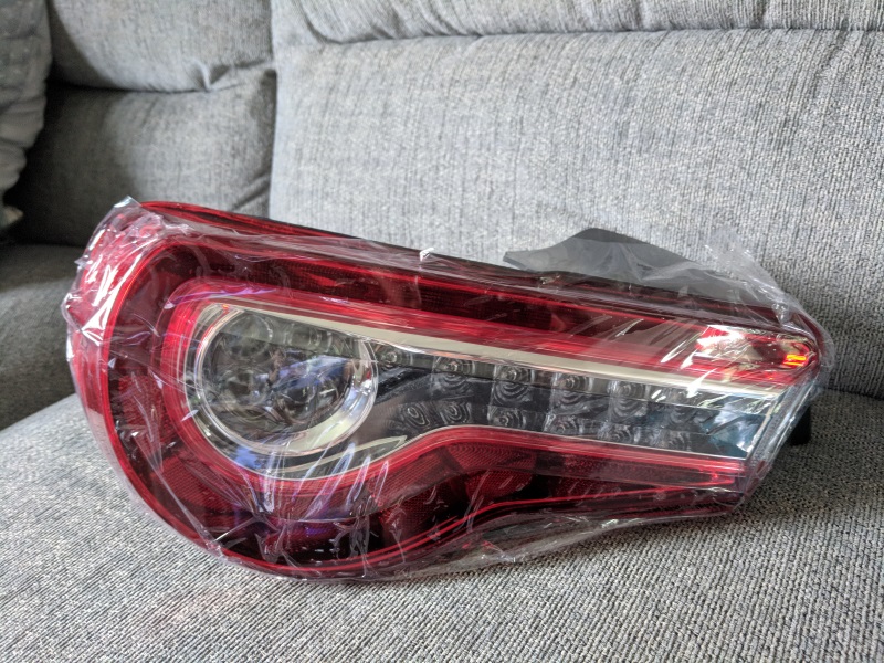

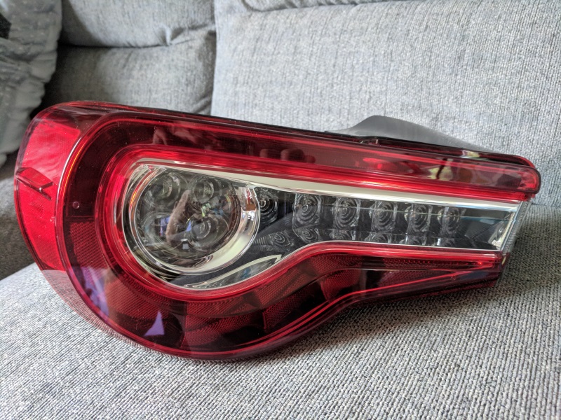

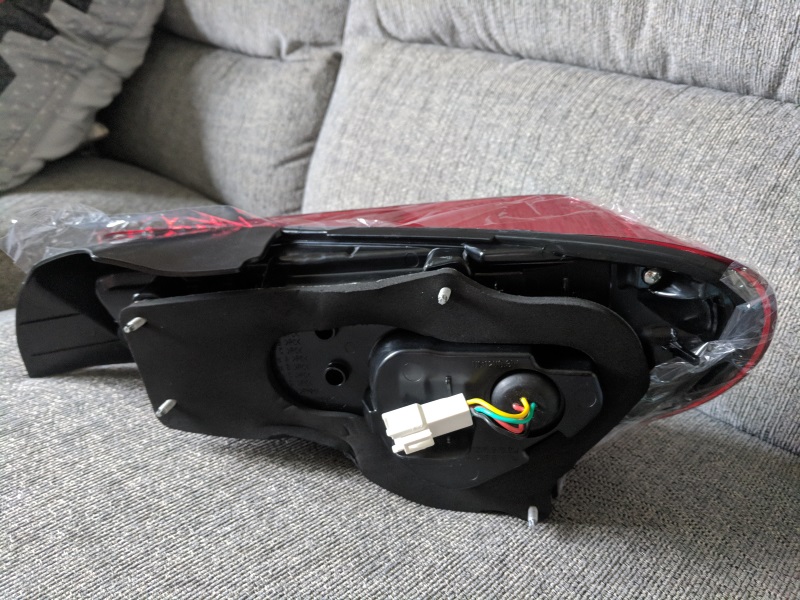

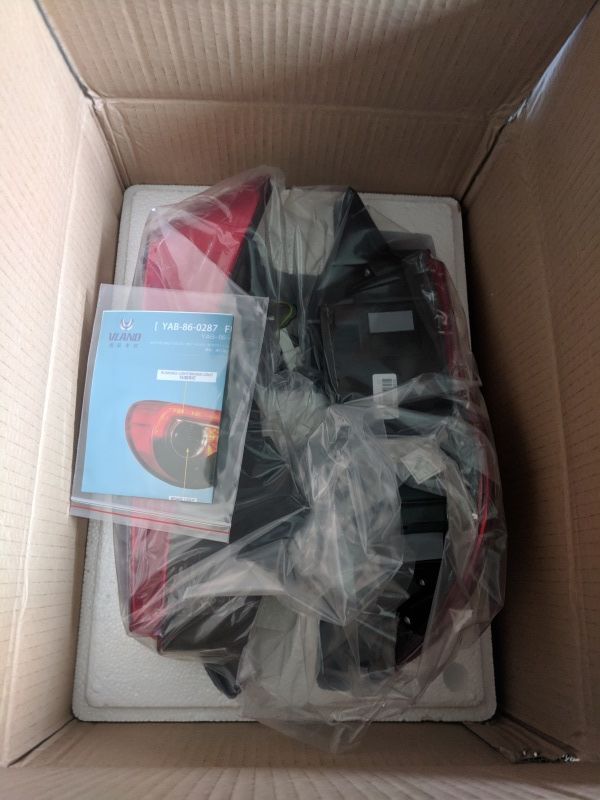

Well considering these were sent on the weekend, I paid no import duty either and arrived today..... so well chuffed. Came well packaged and wrapped too, gaskets are also attached.
Here's the 1st set of images:

From the pics, those look to be just as nice as my OEM tails. The sequential turn is nice too. Hopefully fitment and quality is spot on!

They look great for aftermarket units.

Does anyone know if you have to re pin these or are these plug and play on usdm ?

They were P&P on my UK car so you'll have to repin them.

They looked pretty dang good. The fitment was great, Gaskets needed to be adjusted a bit to seal properly (Use a spray bottle after installing and make sure you don't feel any water coming into the back side). Also had to repin them since USDM has the Running and Flasher wires switched. (Youtube has instructions, just look up Repin BRZ tail light, it wont be the exact model, but close enough).
