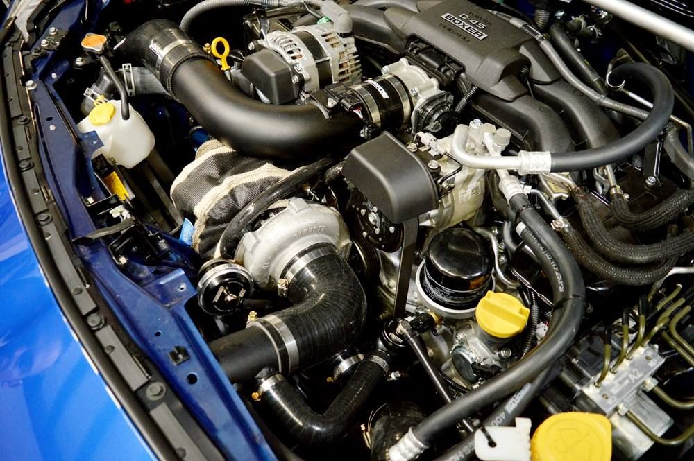

Its a Sydney Motorsport Engineering EFR kit which looks something like this
I have the turbosmart wastegate and blow off valve, ceramic coated hot parts + full dei titanium heat wrap
Clutch and fuel pump to go then full flex tune.
I am surprised there isnt much info on the borgies for this car. I'll fix that with heaps of pictures and videos!
