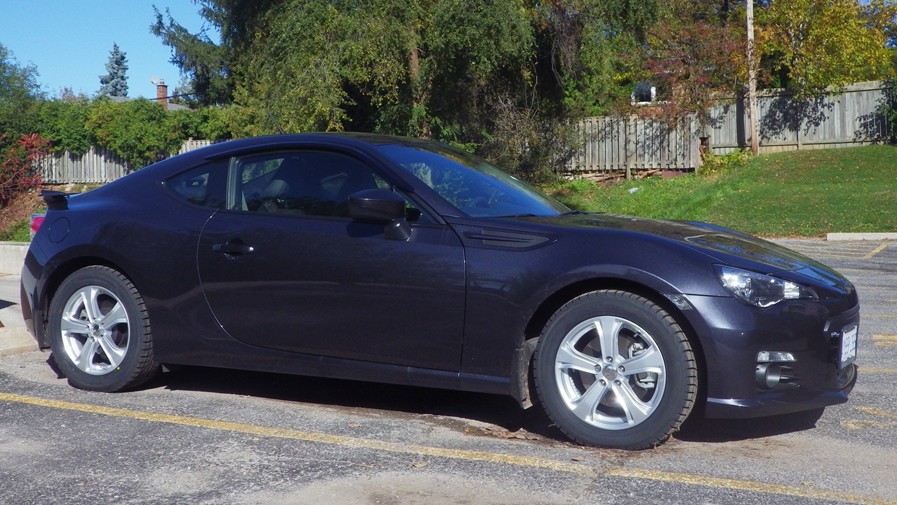

Put my new boots on yesterday (coming from stocks to yokahama ice guards) and found they break loose a lot easier from the line and that the back end feels like it wants to step out a bit more in a corner if I get on the throttle like I have gotten use too.
