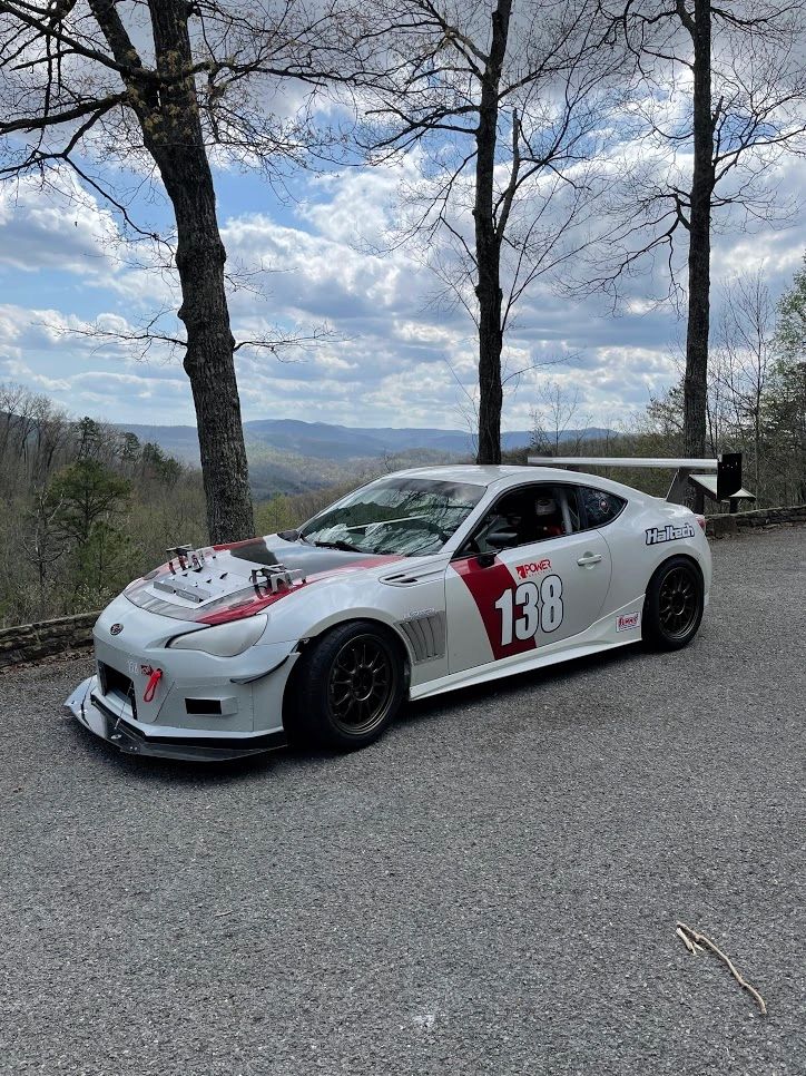

Haven't updated this in awhile, but I went to my first hill climb last weekend and did a write up if anyone is interested. Car/motor is running great other than some simple exhaust issues.
https://sandlotmotorsports.com/f/my-...-to-be-a-racer
Looks badass!

Car looks great! Since you are k24 swapped, have you experienced any driveline vibrations with the single piece aluminum driveshaft? I’m wondering if they worked out driveline vibe with better pinion angles with the k24 kit.
Also, what side mirrors are those? They look great.
I have not had any issues with vibration yet, or feel that vibrations are so bad its undrivable or anything. I had solid transmounts when I had the FA20 but since went back to rubber, and I would say the NVH is about the same between semi solid FA20 and rubber mounted K24. I also have a raised and solid mounted rear subframe so that helps with the driveshaft angle for sure.
The mirrors are carbon no name rip offs of something, I got off ebay for $40! lol

Why did you mount the headlights to the hood? Wouldn't it be more aerodynamic and just as functional inside of the OEM lens?
Short answer is because SCCA told me I had to have headlights to run that class, and that was the easiest way to do it.
long answer is because I built by own custom tube radiator and "headlight" mounting setup to run the radiator in a different position. I had to gut the stock headlight housing to get them fit and therefore cannot run OEM headlights anymore. Which at the time I didn't expect I would need headlights anymore but then SCCA's stupid classing rules came along and forced me to come up with something. We needed headlights for our champcar car anyway so it kinda worked out.

Ah so that was just temporary. If you need a more permanent solution, you could mount the LED pods behind the lens of the OE headlights similar to what some Formula Drift teams do.
yeah I had considered it but those brackets made it real easy but I may go back and do that!
I think this will work out.
Looks sleek! For your use it'll be great, as they are still "functioning" headlights
