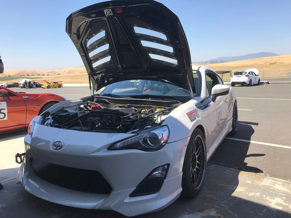

Just a small, happy update. We got to take our Harrop Shop car out for its first shake down last weekend. Day 1 was a private track day with only 5-6 cars. The car did about 75 laps all day, on 91 and didn't skip a beat. Track temps were about 85-90 all day, and the car experienced ZERO heat issues. Something we were not use to with the previous SC setup.
Day 2, we were actually logging with a friend's borrowed AIM Solo DL(ours for this car hadn't arrived yet) so we only logged Engine Oil Temp and Coolant temp, as those were issues experienced last season. Day 2 was also Round 6 of our NorCal 86 Cup time trial series, so the car would actually be pushed a little harder. We decided to run an e50 mix of ethanol and 91, boosting the power significantly. The car is running the Delicious FNG Harrop Tune, optimized by @Zach@delicioustuning
Peak oil temps were only 210F with peak engine coolant temps at 200, both temps stayed rock solid for a 20 min session. Our setup is using the OTS Harrop Oil Cooler, and Stock Radiator and a Varis vented hood, along with some cheap sheet metal ducting. Track temps were @ 90F.
On a plus side, this car took 1st in the super modified class!
Hope to be back next month with some actual hard data. Intake temps, coolant, and oil temps for the whole session, etc. We did not experience any heat soak power wise, and the car felt just as strong at the beginning ging of the session as it did at the end. In fact, after a hard session, you could pop the hood and rest your hands on the SC with no discomfort. Needless to say, we are VERY happy with the Harrop kit, and look forward to many more hours testing on street/track. After all, this car drove the 2 hours too and from the track at well!
Thanks!
