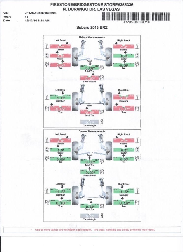

Firestone on N. Durango in the top left corner of the city. Ask for Alex. He's apparently the guy that does the alignments for the exotic racing experience at LVMS, and he's very comfortable aligning to given specifications instead of OEM spec. Since I got the lifetime alignment package, he said come in before an event, he'll tweak it for that event, then come in afterwards and he'll reset it back to daily driver spec.
Thanks for the recommendation gramicci101! I'm very pleased with the alignment results from these guys.
