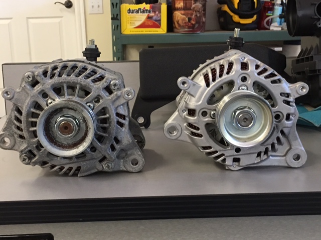

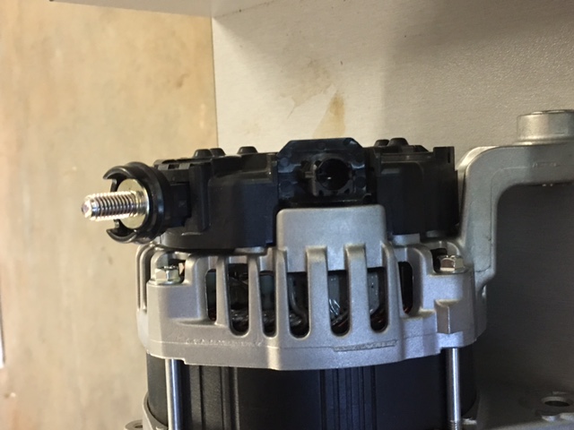

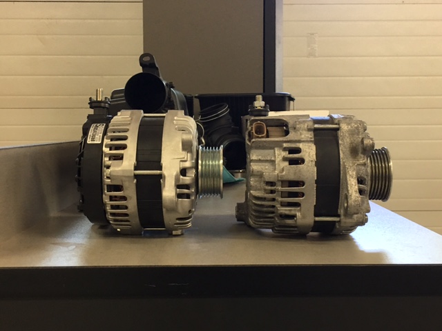

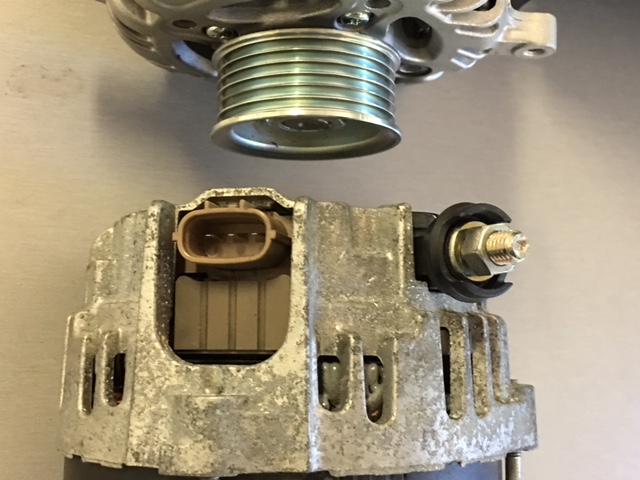

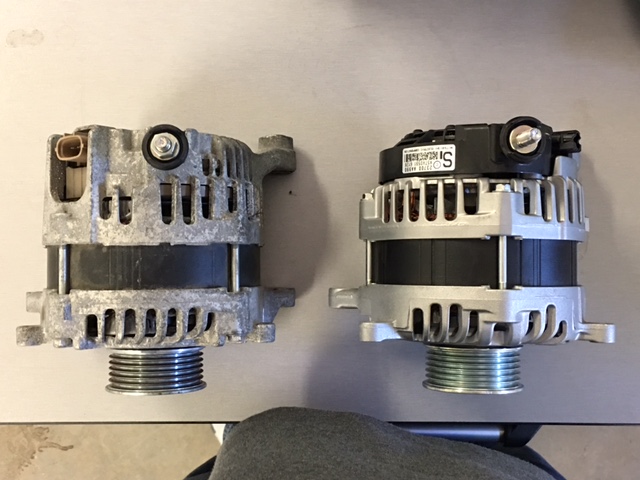

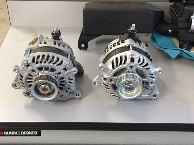

Originally Posted by brzaapi View Post
This may be a bit preliminary, but a word of caution/warning to all 2017MY Subaru BRZ Manual owners who are looking to add the EBSC.
The supercharger assy does not seem to fit. At the moment I believe this is due to a change in alternators from the 13-16MY to the 17MY manuals. The ones with the updated engine and intake (red) manifold are a little different, but you can see that the two cables/plugs are in different locations (mainly on top). This keeps the SC assy raised about .25 to .5 inches from actually touching the passenger side of the engine block. You can't clocked the cables out of the way, like you could on the 13 - 16MY cars.
Edelbrock, has been contacted but their R&D team have not had the chance to get a 17MY car in to confirm the issue or check for a solution. The official response is, they will have one soon, but as of now the kit is not cleared for 2017 manual BRZs.
I bought this kit from CSG, ,myself and CSG are under the impression that a simple alternator swap from a 13 - 16 car could cure this problem. But, its hard to find a ton of info to compare sizes, cable plug types, power output, etc......to know for sure. So, its just easier to try an actual early model alternator. I am in the process of attaining one, and I will report back once I have something more to add. Hopefully, a retro alternator will be a fix. But, its just a theory at the moment.
Keep fingers crossed.
Edit Update: I have a used alternator that is on its way to me. It is from a 14 BRZ that had 16k miles on it. I will update with any news once the part arrives.
Update:
I have an alternator in my hands. It was a unit with 16k from a '14 BRZ. It looks older than that on the housing, but the unit looks real healthy otherwise. You can see the differences in the housing/size and location of connectors below. And, although the unit bolts right up with no issues, the control/monitor cable (smaller cable of the two) has a different plug and I will need to sort that out before this solution will work. I may be as easy as cutting and soldering. It may require a harness, etc. But I will report back once I have something more to share, but please see the photos below.

I talked to Edelbrock last week, when I discover the incompatibility with the new style alternators. I offered my assistance as well, but was told that if and when they need assistance that they would let me know. The are looking to acquire a 17MY car, but even if they had it right now it is down the list on the schedule. Its not their largest priority is basically what I heard, and I understand that completely.
I would offer them my car, but I am literally on the 100th step of the install. I imagine they would want me to reverse what I have done. And, I am wiling. But then I would have to remove my Ace Header, flex fuel kit, and ACT Clutch and many other odds and ends...most likely they would prefer a stock car.
Then, if I was willing to do all that. We still need to get the car to them. Then, they most likely would have the car for several months or longer deciding the best way to proceed.
Still, they are not ready to complete R&D on the 17 BRZs...so until they are none of this will matter.
It does seem to appear that all 17 BRZs (not sure about 86s) have the newer style alternator. This will cause a problem with the SC assy fitment. I currently have an older style alternator loosely bolted up to my car, while I am looking into how to handle a harness plug issue. The two style of alternators have different plugs and wiring on the monitor cable (smaller of the two). This is new ground for me, and my experience is limited. I am also getting support from CSG, and hopefully together we can see a simple solution. I don't think a cable will be too big of an issue, but sometimes the worms come out of the can.
But, I would hold off on the EBSC if you have a 2017 for now. Unless your willing to troubleshoot, then by all means find me a solution.
Cause I am ready to try this sucker out.

For you the question may be, more BRZ vs 86. I was informed that the 17 BRZ autos also had the newer style alternator. I have no idea about the Toyota 86s.
Snap a pic of your alternator and I can confirm it for you.
EDIT: or you can look at my pics on a previous post, and see the two styles side by side. That could help you determine if it is the newer or older style.

2017+ uses a different alternator.
