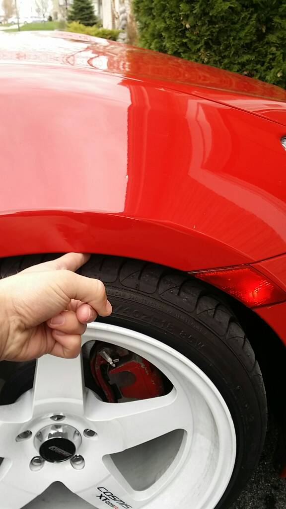

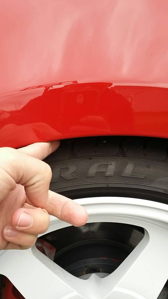

I have 18x9 +25 all around with federal super steel 595s 215/40/18s
I lowered my car I don't rub nor scrape yet. I got some camber in the rear and I maxed out the camber on the camber plates on my front and they still sorta poke. Getting camber bolts mounted soon. You will be flush you might poke a tiny tad in the rear. But this is what my car looks like. And i haven't rolled pulled fenders Name:  uploadfromtaptalk1398981227336.jpg
Size:  115.5 KBName:  uploadfromtaptalk1398981236974.jpg
Size:  86.3 KBName:  uploadfromtaptalk1398981282995.jpg
Size:  57.5 KBName:  uploadfromtaptalk1398981291446.jpg

Thanks for the reply! That's interesting that the camber from the coils still make the front poke a little. I had the wheels I listed on a 2005 Corolla and the coilovers cambered it enough for no poke, I figured the FR-S wheel base was a little wider
Was 225 too big for the front? My wheels are staggered so I'm wondering how wide I can go on the back.

Yes they poke and if you research the frs suspension you can learn a bit for when you adjust the suspension. The rears are like double wishbone suspension. As you go lower you will get camber. My fully adjustable coilovers have camber plates for the fronts. And the front is a sorta confusing setup from what I messed with. But I will add another negative 1.75 camber to the fronts so it can be the same as my rears. So they won't poke. And i believe you should have room with 225s I'm on 215s and I'll go straight up my driveway without scraping and I don't rub at all. I'm planning on going lower so that's why I have my 215s. I like the staggered idea you are going for I kind of wanted that but I got a good deal for these "fake wheels" so I can't complain. Hope my input will re a good your goal
