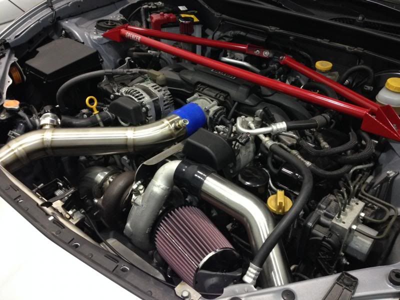

Forgot to add another picture, The lower pipe on the intercooler is just under 2.5" so the coupler wasnt getting a good seal. So I cut it off and welding on an actual 2.5" pipe with a nice bead roll on the end.
I'm sure I'm preaching to the choir here but weld where you can. Anywhere you have a rubber coupler leaves room for you to have boost leak at one point or another. A friend of mine bought a "plug and play" kit for his car that used rubber couplers and almost every one of them leaked no matter how much he tightened them. It wasn't until he went and had a shop fabricate his intercooler piping into a solid piece that it resolved his problems. I'm sure his was a worst case scenario, but a coupler will always be a weak spot.
Yes couplers are possible leaks but that's why my pipes line up just right and are bead rolled. I've never had an issue with any IC piping I have made. I'm 100% confident I will not have boost leaks in this setup. The best option is Wiggins clamps but they are almost comically exspensive. Vibrant does make a lower cost version but they are not offered in a wide range of sizes. Also durability is a strength of the stainless piping. It wont crush under a strong over tighened clamp.
Also all the points where the piping ends it's aluminum to steel. You can't weld those two together. Boost leaks are a very simple problem to avoid with a quality fitting kit.

It didn't even sink in when you said "on the intercooler". I thought you were referring to just the piping. My bad. Yeah aluminum to stainless is a no go. Proceed sir, proceed.

Been a while since I have done a bumper on mock up, here its the bumper loosely on to make sure the air duct clears.
