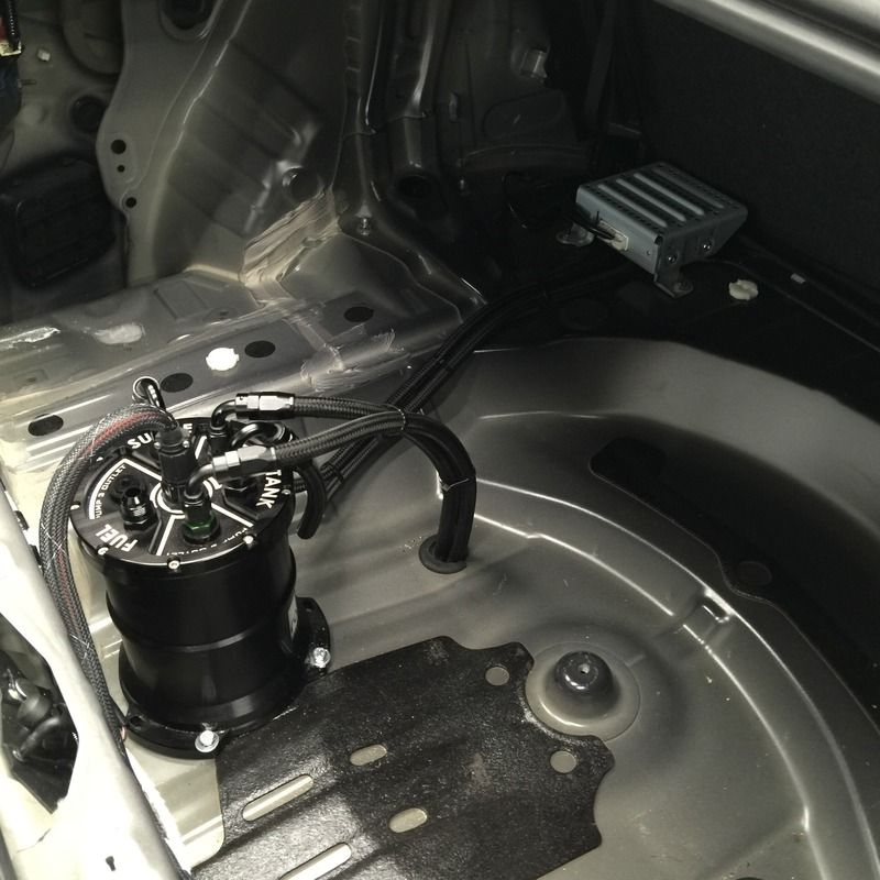

Brought the car back to the shop. Transmission shipped yesterday, so that should arrive next week. Installed the surge tank and some of the plumbing. Walbro 485 on the factory fuel controller in the tank, feeding a radium surge tank with 1 walbro 450 full time, then 1 walbro 450 on a pressure switch activating on boost only. Then the factory direct injection pump under the hood

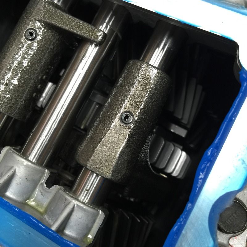

Faceplated goodness
Test fit of the custom bellhousing and trans on a junk block. Perfect

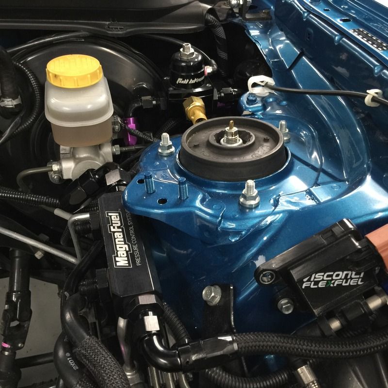

Finishing up the fuel system. 10an feed up to the fuel distribution block. Dual 6an to the rails, 6an to the flex sensor and di pump.

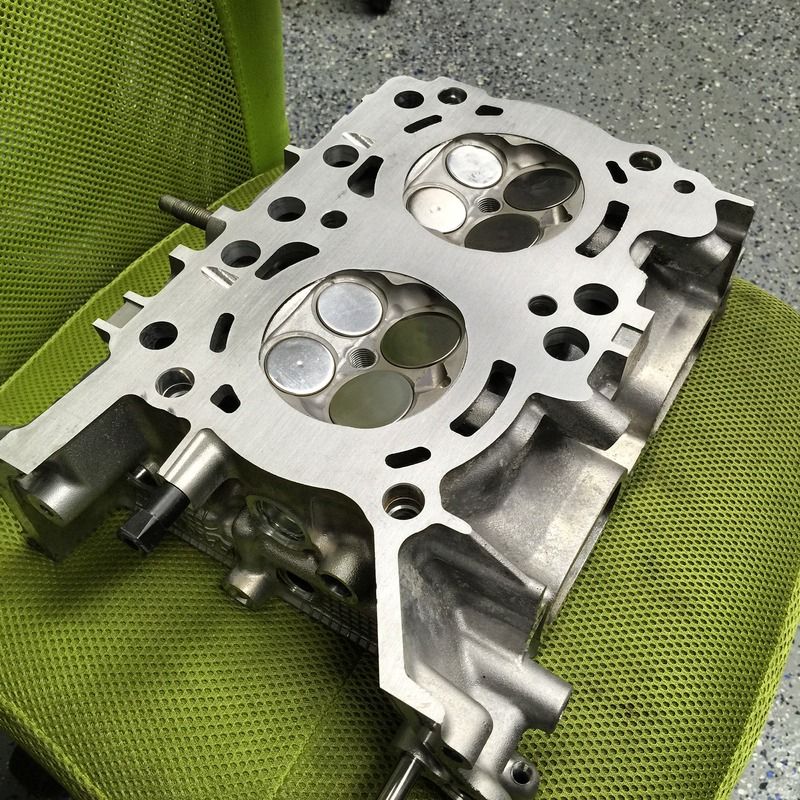

Heads decked and ready to go with ferrea valvetrain
