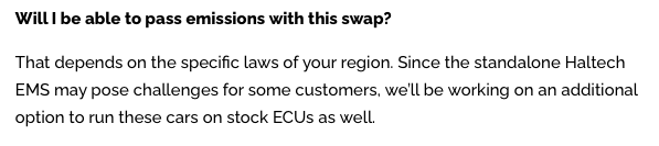

Always cryptic with your words sir. They mentioned in the blog there would be a stock ECU option, and Solidsnake11 was running it with ECUTEK. I already have ECUTEK, so should I hang onto that and my stock ECU, or should I get the Haltech? They said to save the stock throttle body from the FA20, but I have pretty much recycled or tossed all the other sensors/parts, so if this is an option then hopefully I didn’t toss other things that are needed.
They also mentioned there would be a base tune on the Haltech to get someone down the road to a dyno tuner.

Oh I recall, and it has been mentioned here. "Imagine if it had been standardized..." dot dot dots made me think you were referring to something in the works, as it 'there is more to come', but I see you were just saying, 'what if?'.
KPower has mentioned a stock ECU option, but I don't know if their solution is the stock K24 ECU without CANBUS, or if it is the FA20 ECU with a K24 piggyback ECU setup, or if it is something similar to what Solidsnake11 did--an adaptation of the FA20 ECU with ECUTEK. I don't think it will be the latter, but anything is possible.

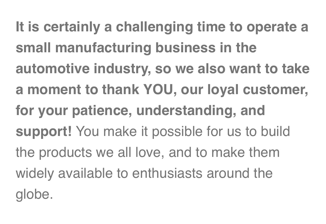

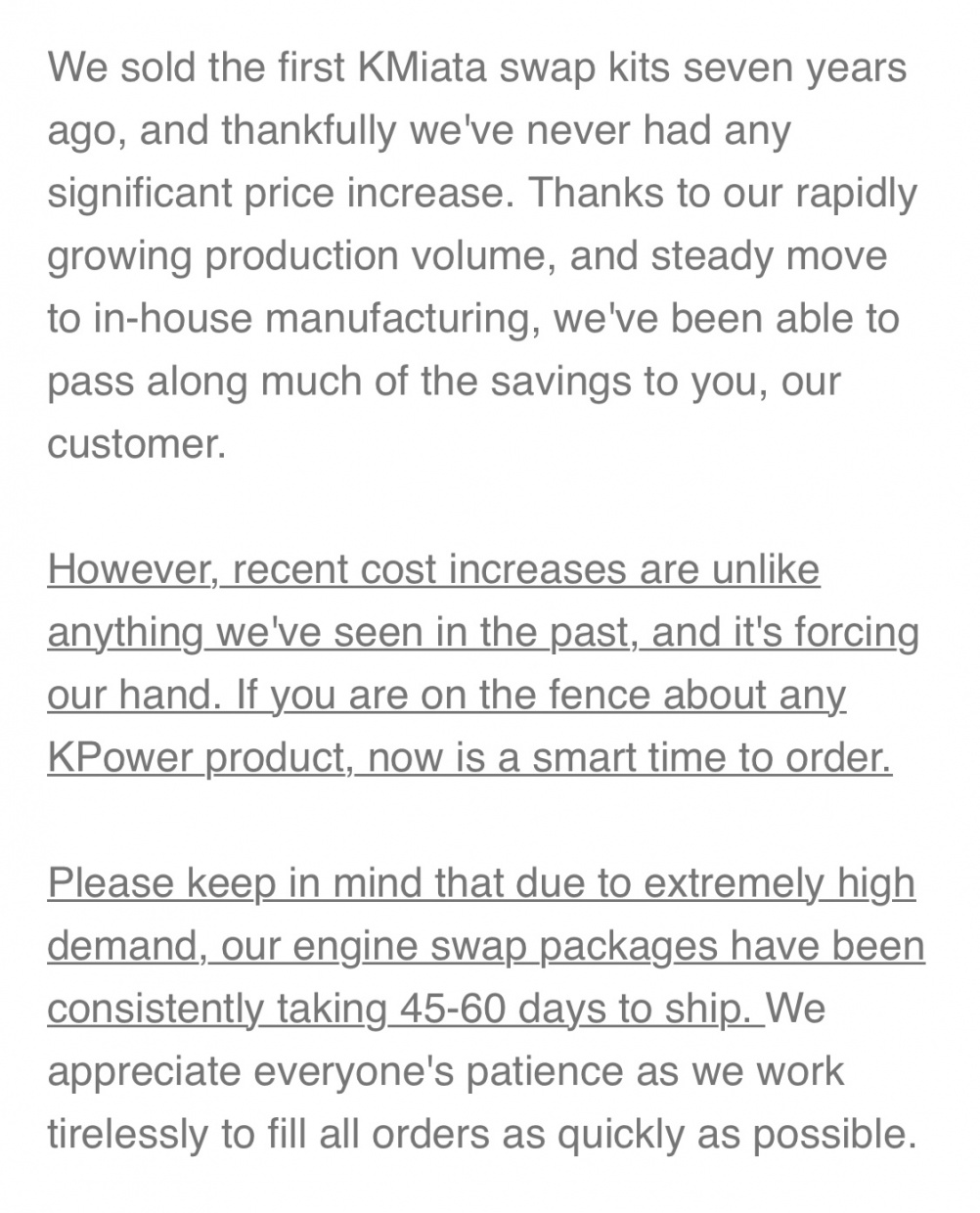

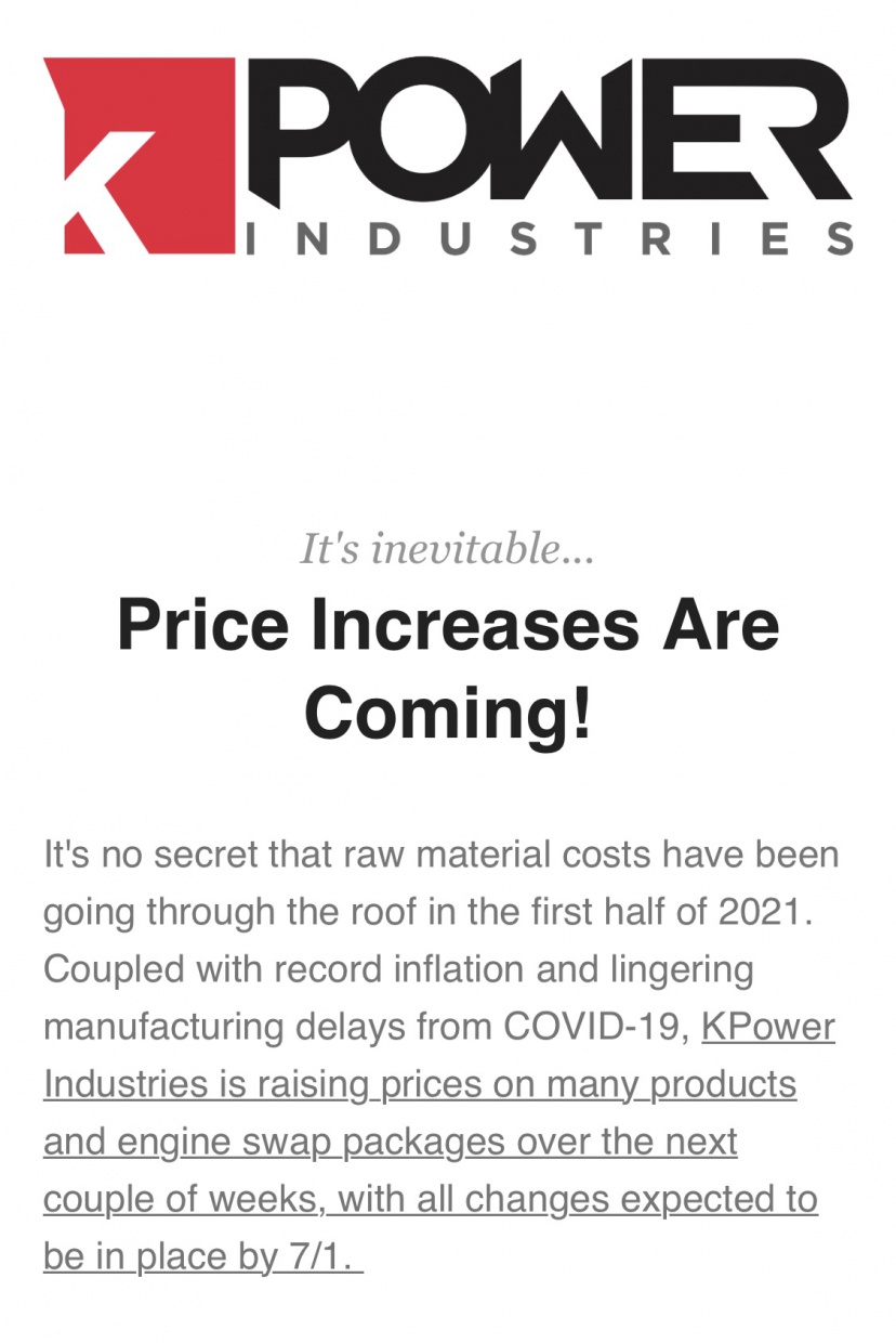

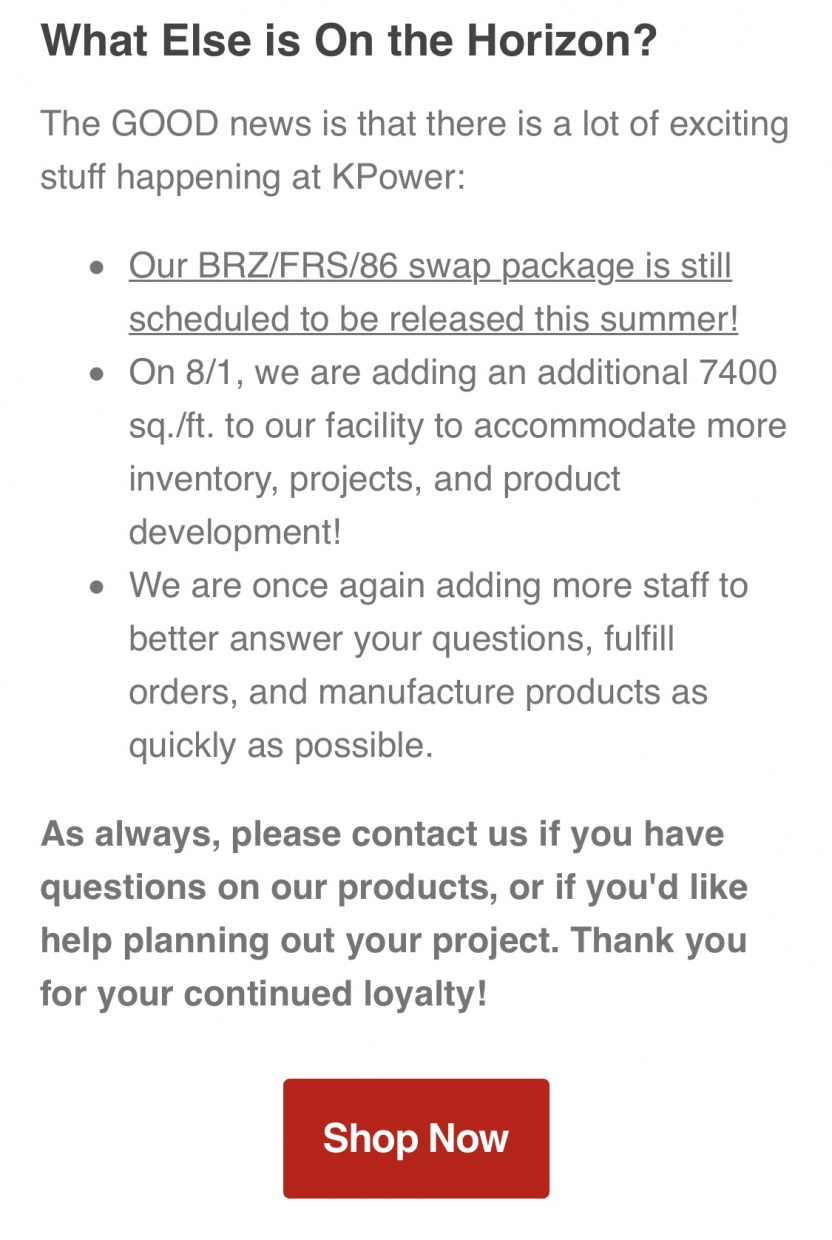

From their newsletter:
