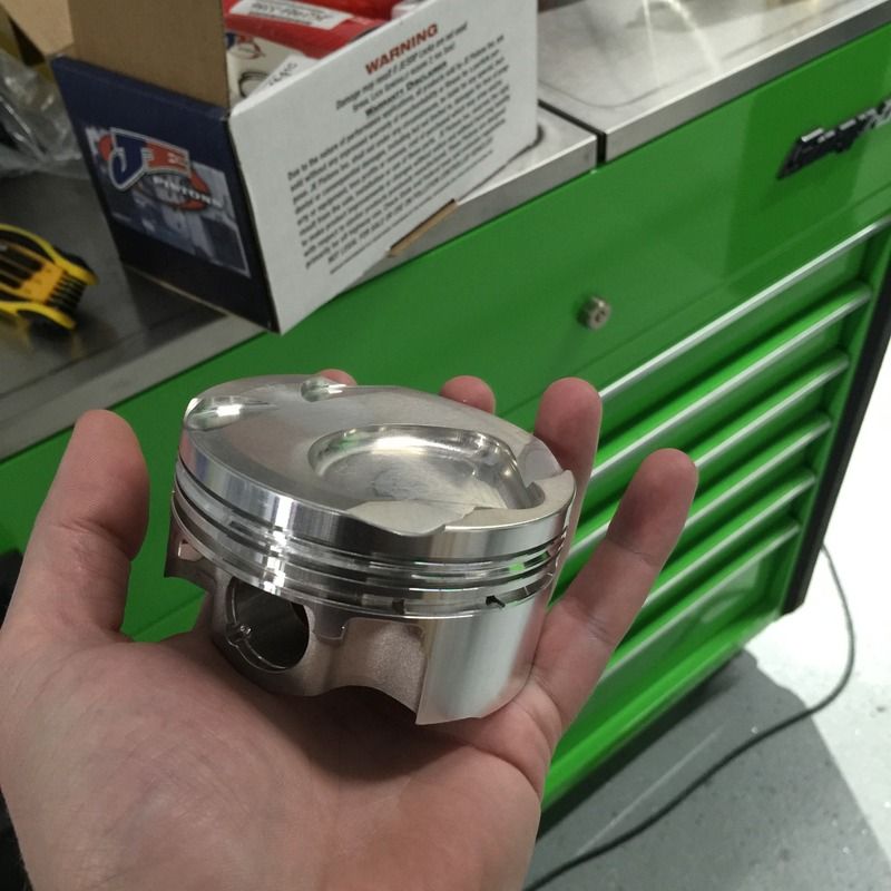

More parts coming in. Je finished building these and got them to me

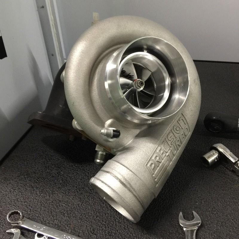

Mentioned: 27 Post(s)
67mm of awesome

Awesome build, did you ever consider T4 twinscroll?
I have an open t4 flange manifold for this setup. Not too worried about spool time, it means almost nothing for drag racing. A legit twin scroll would be nice but for the pricing I can't beat what I've been given

Thanked 145 Times in 113 Posts
Very cool! I wonder what the spool is going to be like haha, I am going with a 6466 and was thinking of spraying a small shot to spool it!
Who knows. Lag doesn't really mean much to me for drag racing, Im in it for power. Im sure the cams should help a little, but mostly up high
