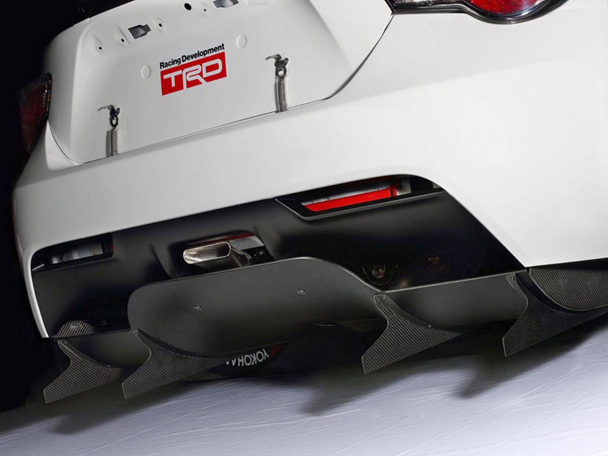

Coming along very nicely! Saw the other pictures of the exhaust setup, looks really good. Why not go with a central exit exhaust with a more efficient (and an ACTUAL) custom diffusor if it's going to mainly be a track car though? Car begs a Porsche Cayman style exhaust exit...

Less unnecessary mass, more centrally located mass (reduced MOI for quicker responsiveness), and is easier to make a more effective diffusor when you don't have a large muffler with dual tips being in the way of things out back.
See this example...
The only reason the FR-S has dual wide rear exit from the factory is for looks... it's not for performance goals.
