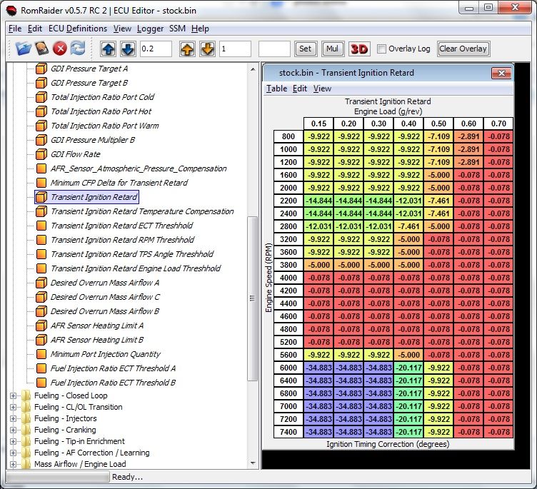

pulled my rom - ZA1JA01C
when saving as hex got a msg:
"this rom image contains sections of invalid data which must be zero padded to make a contiguous file. It is possible upon subsequent loading of this file that you might flash over valid areas with these zeroed areas."
the files was saved with first x8000 (32768 dec) zero padded, 1.25mb.
i was also able to open the file in RomRaider with RR_ZA1JA01C.xml def file (from this post http://www.ft86club.com/forums/showp...2&postcount=12)

some folks are reporting the roms needing to be zero padded. i don't believe it's an issue at all, and it should work fine for you.

that was exactly the point of my post, everything worked fine out of the box!
