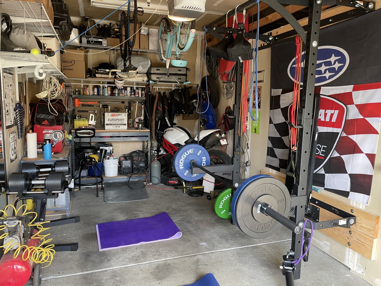

I got a hoist and engine stand. I pulled the transmission and driveshaft today. I’ll be pulling out the engine tomorrow and mounting it. I might pull it apart too if I have time. I’m doing this all from a one car garage that is pretty packed, so it is slow going.
