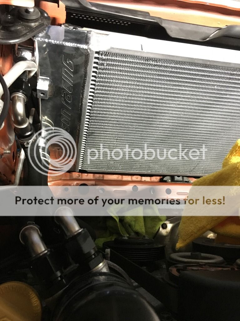

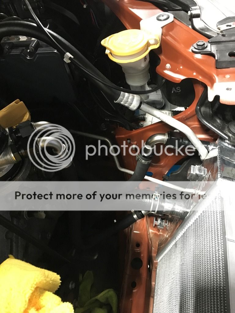

well, after 8 months installed. The hose busted, and the oil leak was bad.
It was installed by a reputable installer and the kink was really minimized. I believe installer even called JR to ask about the hose kinking issue. The soft bend area broke. I guess the rubber inside just get hardening overtime and break at some point. So even a soft bend is not safe.
Hope Jackson Racing can solve this issue.

In my opinion braided steel lines is the way to go.
I had similar failure using the same lines. Hope Jackson Racing offers braided steel lines as an option for this kit.

I went to install this kit a year ago and found the lines to be unacceptable. The shorter line had a kink regardless of how it was installed. Line failures like the one shown above aren't surprising.
Just built my own lines using Earl's ultra pro nylon braided hose and fittings. Hoses are PTFE lined and have a 2 inch bend radius so they can tolerate tight bends without folding or losing shape. The dual radiator should have came from the factory with these lines...
Two hoses are compared below, bent the same amount.
