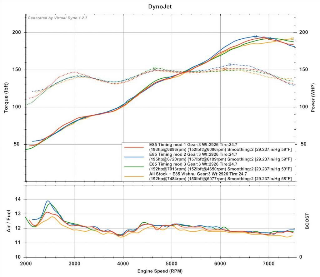

I advanced the timing about a degree at the higher load and RPM areas to the OTS E85 rom and went and took some logs again. Also fueled up right before like the other times. This is what I got compared to the best pull I did on the OTS map and a bit more learning.
As you can see, there appears to be a bit of increase in power at the 5800-7100rpm range. Pretty cool stuff. I will need to dial in the maf scale more at the low voltage range, it looks like. I will try to log some more pulls tomorrow to confirm results.

Is virtual dyno a substitute for a real one?
Sent from my Galaxy Nexus using Tapatalk
s2d4 is offline   Reply With Quote
Old 04-14-2014, 11:37 AM   #1666
Kodename47
Kodename47's Avatar
Drives: UK GT86
Location: UK
Posts: 3,040
Thanks: 185
Thanked 1,633 Times in 1,113 Posts
Mentioned: 156 Post(s)
If used correctly, as above, then you can get good comparisons. As for actual figures etc, no.
