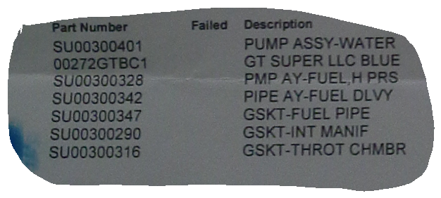

Originally Posted by 748mono View Post
they changed the fuel pump and the noise is worse now then before.
Check the part numbers and see if they are different than mine. I have put over 1,000 miles on since my fix and everything is still good.
