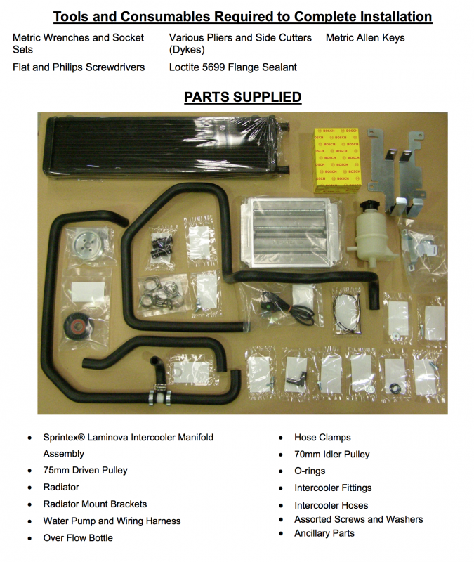

Was poking around for lifespan/maintenance info on the innovative unit, found these.
Intercooled installation manual
Intercooler upgrade kit manual
utekineir is offline   Reply With Quote
