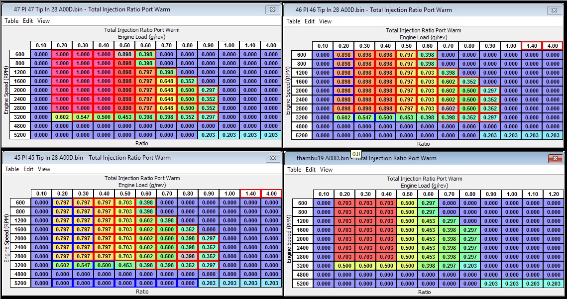

OK here goes my latest
Here's my latest attempts to understand and push the limits of the @thambu19 principle. I'm going to try out these four shown.

Originally Posted by KoolBRZ View Post
How on earth did you figure what numbers to use where? It transitions smoothly the way it is. Should I try using more than .7 at .2 and .3 load? How about using 1.0 PI only at .2 or .3 load in the low rpms?
I am pleasantly surprised it worked. To be honest I plucked those numbers from my a@#. Few simple guidelines were followed
1. Going DI at low speed knock limited regions will increase volumetric efficiency and improve knock resistance
2. But going DI will make combustion slower so need to add more spark
3. The lower the speed the sooner the transition from PFI to DI because of same reason above.
4. Use PFI at loads that are not knock limited to improve fuel mixing and take advantage of faster combustion of PFI. This should reduce combustion variance and make engine feel more stable (less stumble)
5. Make sure to use 100% DI at the torque dip region
6. If it was upto me I would have tried 100% PFI at Idle. I think Toyota went for DI there for emission gains and to avoid knock during HOT RESTART. With PFI they need to model puddle dynamics when the engine is cold and other stuff. With DI they get better fuel control. I dont know if they are even going slightly lean at Idle for fuel economy reasons.
7. Going 100% PFI should also reduce the chirping??? I dont know for sure but worth a try. To really reduce chirping the fuel pressure must be dropped for DI at idle and then going 100% PFI. This is because even if DI isnt being used the pump is still working to maintain fuel pressure. Currently 24bar or 2.4mPa fuel pressure is commanded by the DI system at idle raising to 200bar pressure at WOT.

Here are 3 more attempts to improve on @thambu19's table. His Total Injection PI to DI ratio table is so smooth. There is only a slight delay transitioning to full DI, and I think timing advance could fix that. The question I want to answer with these attempts is really "How much is too much?".

@KoolBRZ you definitely need to adjust the timing where we have increased DI % from stock cal
Everytime you flash are you making sure to relearn the background noise of the knock sensor by doing a partial load sweep from low to high engine speed? Normally you start at 2K rpm low load and slowly let rpm build until 6K to 7K (not WOT). This helps ECU learn background noise caused by valvetrain and other components. Helps ECU call knock more accurately and overall a consistent knock detection instead of too early or too late.
My only concern with flashing is ECU loses the chain stretch information. This is usually accounted for because when the company flashes a cal at the plant the engine will learn the relationship between crank and cam and then on wards it will use this relationship to estimate how much the chain has stretched. For example initially when the chain stretches a lot when new the cams can get more and more delayed in actuation or cams can get retarded. Some OEMs can use the chain stretch info to position the cam after discounting the stretch. What I mean is physically the Intake cam could have moved to 42deg instead of 40deg retard. What Ecu can do is move the Cam to 2deg more advance thereby engine is actually getting the needed 40deg instead of 42deg.
