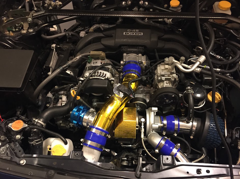

Put some more work in last night. I put the hose clamp on my last pcv hose last night. I also routed my wideband cable. Put the heat shield on the turbo.
The Sound Tube is capped off with the turbo kit, so I used it to hide the cable for the wideband. Worked perfect(although it took me 10 minutes to get the plug through the hose).
