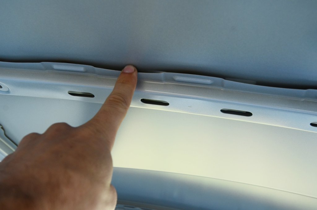

Originally Posted by userjack6880 View Post
Quick question - what's the gap between the headliner and the bit of frame running down the center of the ceiling? Also, what's up there? Never can find a good picture of a headliner-less ceiling.
I've got something cooking, just want to do some research beforehand.
Originally Posted by Anthony View Post
Don't know, haven't gotten that far yet. But I'll take a picture when it's half-off so maybe you can see what the gap or stuffing is like.
FOR SCIENCE!!!!
I used my finger for reference. I would say my finger is about normal size.
Build Thread | The Venus Project | Any car which holds together for a whole race is too heavy.

Old 12-29-2013, 04:44 PM   #131
userjack6880
userjack6880's Avatar
Drives: Raven FR-S MT
Location: Starkville, MS
Posts: 341
Thanks: 81
Thanked 148 Times in 101 Posts
A great help to those who aren't stripping their machines, but would like to know what's behind the plastic.
Is there a chance some measurements could be made on the foam spacer near the dome light and metal support in the center? That would get some good ideas on what the gap space is.
Also, how much weight have you lost now that the headliner is gone. :P
I'm feeling pretty sick now. I think I might be getting a cold. But as soon as I feel like not death, I'll get some measurements for you.
