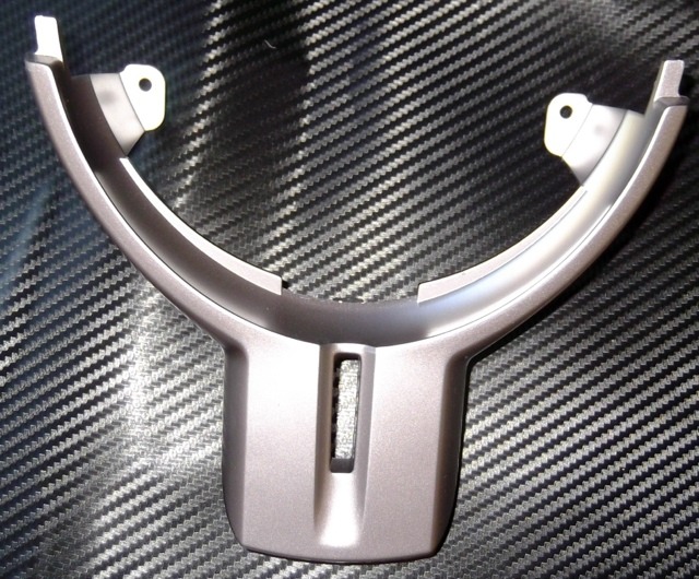

Upon removing these two screws there is a clip on the lower spoke of the plastic but this pulls out very easily.
This is the plastic removed from the wheel.
Attachment 15184
This is what it looks like after about an hour of heating and stretching, heating and stretching, heating and stretching - you get my drift and reinstalled.

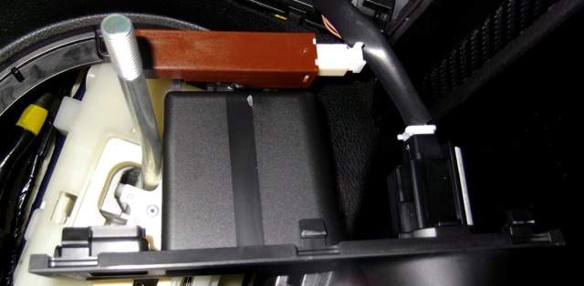

The only difficulty I had with this was getting the USB/Storage Hole/Starter Button Panel out. In the end I ended up pushing out the USB port, as this is all I could touch with the limited amount of room behind the panel. Upon removing the USB port I disconnected the wiring, pushed the wiring back into the centre console and then hooked my finger through the empty USB hole and managed after a couple of attempts to get the part out.
Attachment 15186
It is held in by 6 rather large tabs, one of them sustained a small amount of damage coming out (centre one) but it did re-engage fully upon replacing it.

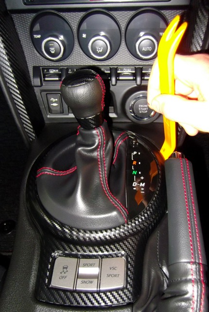

Part of removing the USB/Storage/Starter meant removing the gear stick surround again. I found the easiest way to remove it from the console was by putting a trim removal tool in here:
Attachment 15189
I'm really happy with how it all turned out. The only slightly disappointing piece is the gear shift knob as it is really difficult to trim the vinyl around the top silver disc without either nicking the leather or cutting it too much and exposing some silver, but I am going to be swapping this out for a TRD one anyway.
