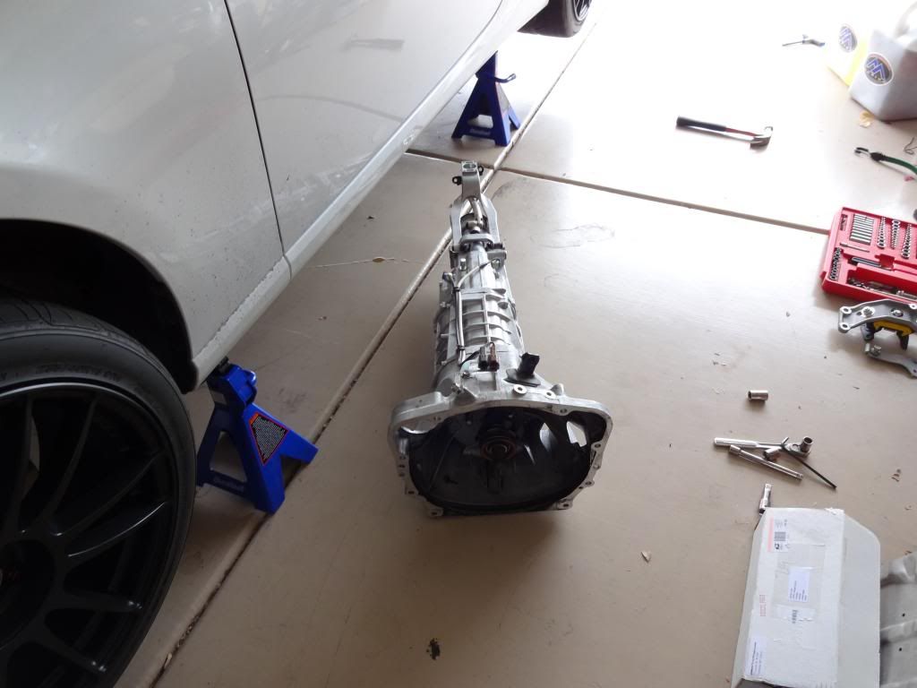

Mission semi accomplished!!
So I'm putting in my new FX400 Clutch and am almost halfway done...just thought you guys would like a pic that many won't ever see!
Also for anyone who cares it weighs 86.2 Lbs which is damn light for a tranny!!!
Merry Christmas!

Ok this is just a heads up, I'm still reassembling everything, but got the clutch in and the tranny back in...needless to say, this is hardly something anyone can just do...
I am planning on doing a DIY, but it's gonna take a bit to get it put together and up on the forum, took a ton of pics, except for me body pressing the tranny back into the damn car...screw jacks, 83 lbs aint shit!!!
It's been an adventure filled with busted knuckles, tranny fluid everywhere (dont ask), and A LOT of four letter words being thrown around. The service manual is worthless, because it assumes you have a lift and $1000 tranny jack laying around. For those of us doing this in your home garage, this is no mean feat. But yes, you can do the entire clutch change out with 14, 12, and 10mm sockets (I recommend using 1/4, 3/8, and 1/2 inch ratchets), a phillips head and flat head screw driver, and a pair of pliers. It's not impossible for someone to do, just have some idea of how a car is put together and you'll be fine...if you think changing tires is tough...well this is not something you should try.

Well got it all together, no spare parts...time for the moment of truth...test drive to make sure i dont suck!

This post highlights exactly why having the right tool for the right job is essential.
Oh I have the right tools, don't get all hoity toity, just because you might have access to a shop or what not. I actually used my jack to get the transmission in place, no body pressing it was a joke. The only thing that would have made this light years easier would have been a lift. How many people do you know with a lift in their personal garage?
On that note, even with my lack of the "right tools for the right job" as Orbital made it so clear...my car drives fine, the clutch works, although its gonna take some getting used to, with a 6 puck clutch you dont really slip the clutch, you can but you have to really think about it. It's also a little noisy, basically when you decelerate with engine braking you can hear the springs on the clutch rattle. The clutch pedal takes a bit of effort to press in as well, not so much that I am gonna be cramping up in rush hour traffic but its noticeably heavier than stock.
