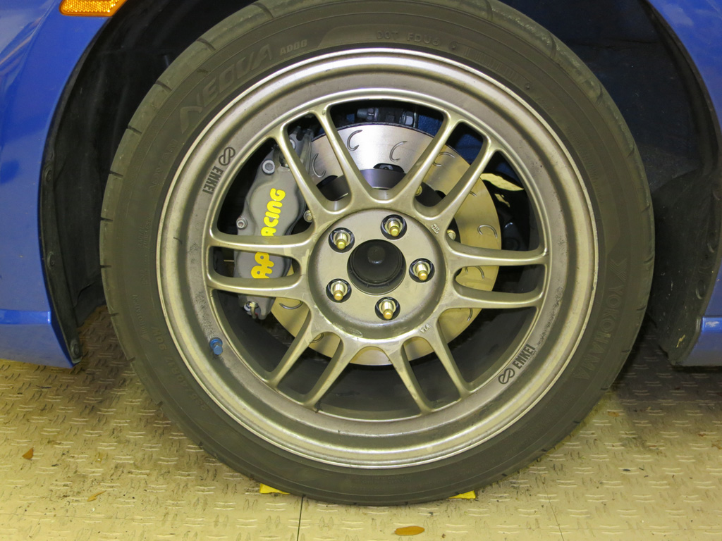

I haven't driven the car since install (bled it but that's it, I'll bed it in tonight) but here's some pics of my brakes after 10,250 miles, 4,250 of which was using track pads (XP10/XP8): http://www.ft86club.com/forums/showp...&postcount=156

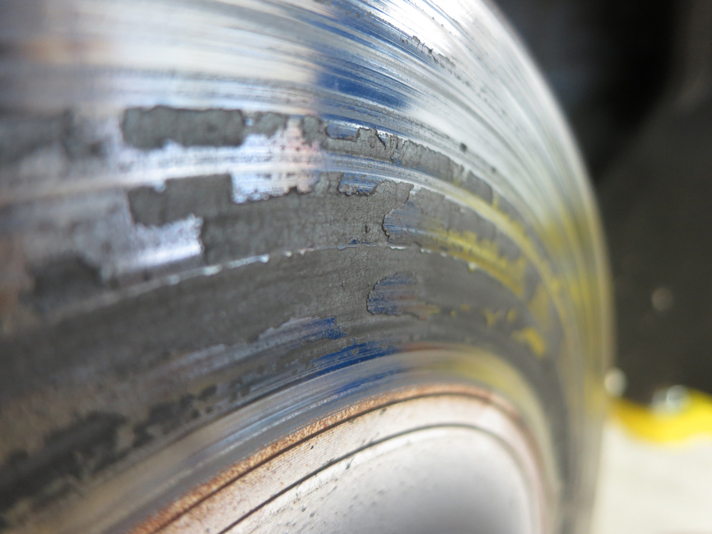

Here's a pic of my awesome (and unique) rotor wear:
And the final product:
But there's a lot more pics in the post linked above. DIY on front wheel studs is posted in the DIY thread also, but assumes a press is available.
That's pretty crazy rotor wear!
How much of that do you think is from the track vs. from using track pads on the street?
Looking forward to how you get on with the AP kit anyow!
It may just be because I didn't turn the rotors before using the carbotechs. I've used track pads on the street in my cars for a combined 50,000 miles at least and have never had a rotor wear like that (including other cars with carbotechs and non-turned rotors :shrug: ).
In the end I'm not sure what caused that unusualy wear, it's definitely not happening in the back with CT pads. I don't believe the pad is to blame at all. My best guess is excessive heat and crap OEM rotors.
Perhaps @JRitt has seen this type of wear before and has some ideas.
