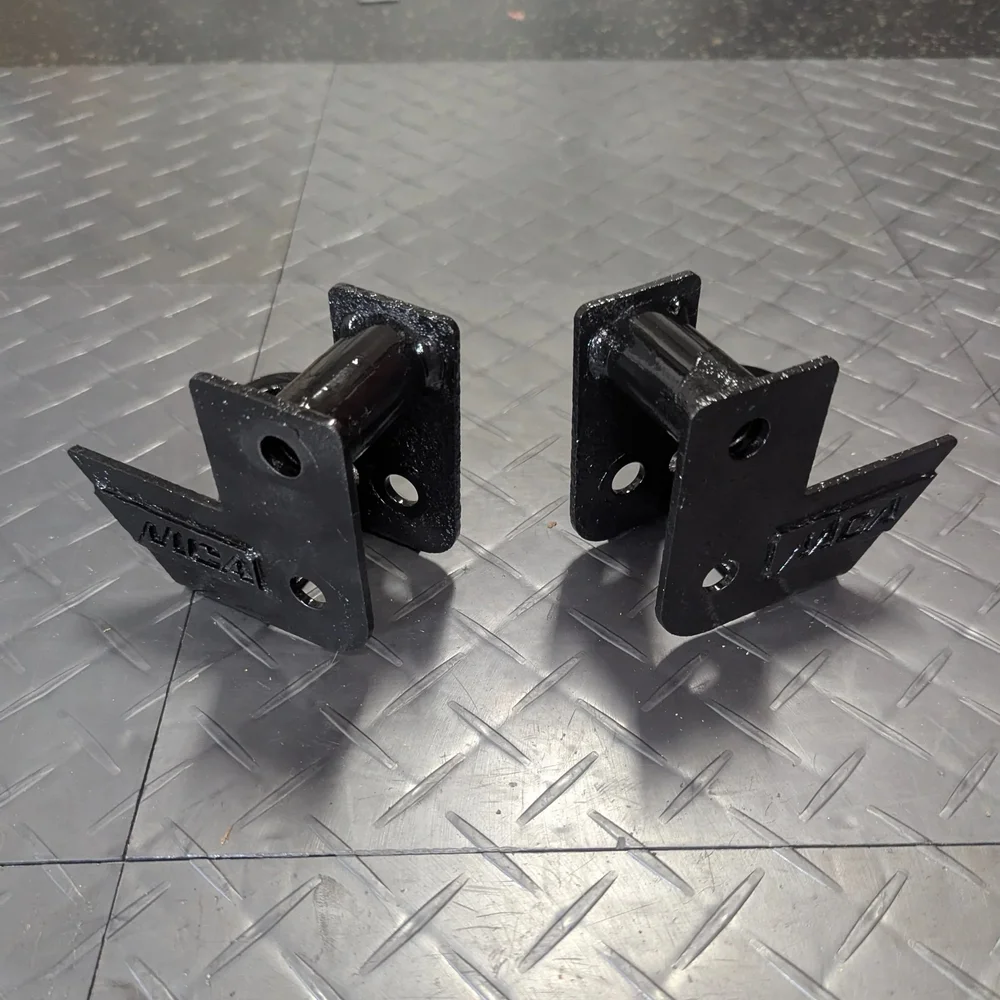

Traction Mod Refinishing
OK - on to the next project! Since I have five days where I don't have clients in my garage, I'm going to try and get everything outstanding done on my car.
Next up after the header swap is refinishing my MCA Traction Mod brackets.
With at best 16,000 kms on the car since they were installed in November 2021 and very little winter driving, I was a little shocked to see how badly rusted they were when the car was up on the lift back in May, so this has been on my mind for the last four months.
Here are some pics of them after removal:
...and here are a couple of pics after cleaning them up the best I could with solvent and a wire brush and then brake clean:
After letting them dry, I hit them with a coat of Tremclad Rust Reformer, and now they have to dry / cure for 24 hours before finishing:
I'll be finishing them with 2 or 3 coats of Tremclad Professional rust paint tomorrow, reinstalling, and then I'll probably spray some Kleen Flo Honey Goo around the assembly for a bit of extra protection.
While I'm waiting for the Rust Reformer to dry, on to my next project... (I'll update this post with further progress on this project tomorrow)
UPDATE 2025-09-28: Refinishing is done, and MCA Traction Mod brackets are reinstalled. The driver's side went in no problem, but for some reason the passenger side one was VERY difficult to get back in place. Took a lot of swearing and levering to get it to seat up in the stock bracket and align the holes, so of course my nice new finish got all scratched up.
Here's a couple pics of them before reinstalling:
Anyway, it's all back together, and I sprayed the whole assembly with Kleen Flo Honey Goo afterwards as a further layer of protection against corrosion. While I had the car up, I also increased the ride height all around to the maximum ride height supported by the RCE SS1's to give me a little more leeway with driveway ramps, etc. It's only 5-10 mm higher than before, but it's something!
