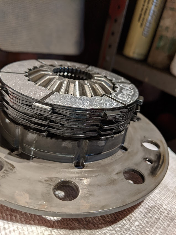

The OS Giken diff is indeed a clutch type diff. It uses finely ground steel plates that aren't coated in friction material so the wear is nearly non-existent and it will last a lot longer than a traditional clutch type diff tat does use friction material.
Go on.... is that true ?? I know the Giken is the go to diff but I didn't know it was supposed to last long. Do they have a published service interval ? Yearly rebuilds have always turned me off switching to a clutch pack diff

Yeah, I bought the OS Giken for my ND used from Noel, sent it off to Jon for inspection and to tweak the setup. Everything looked great, then I ran it and the new owner of the car hasn't done anything besides change fluid either.
OS Giken talks a bit about it here: https://osgikenusa.com/pages/the-os-...-lsd-explained
Someone uploaded a more in depth document here but I hate direct linking PDFs haha: https://www.ft86club.com/forums/show...27&postcount=1
Added a pic of the disks inside my ND's diff after a couple of years of Noel's usage:

Now I just need more money ! Thanks Ken
