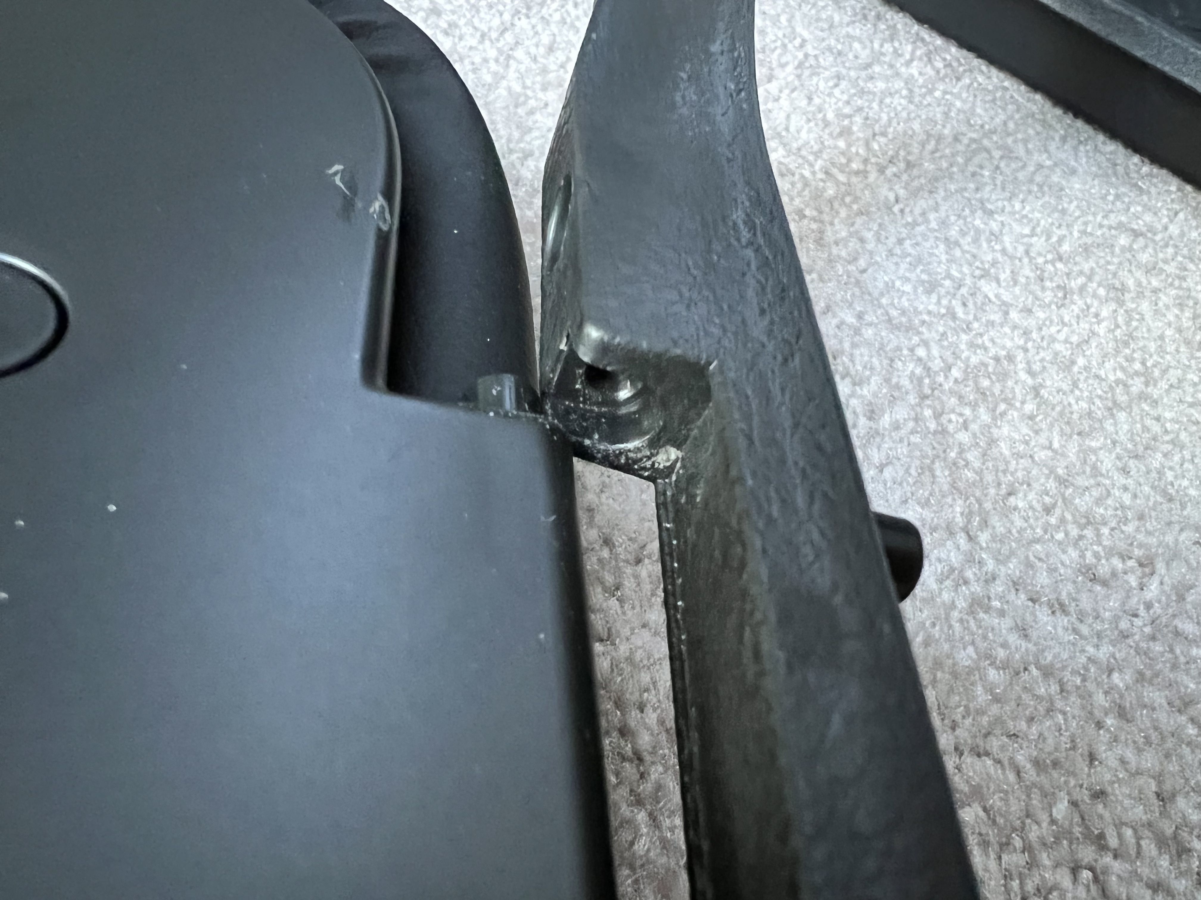

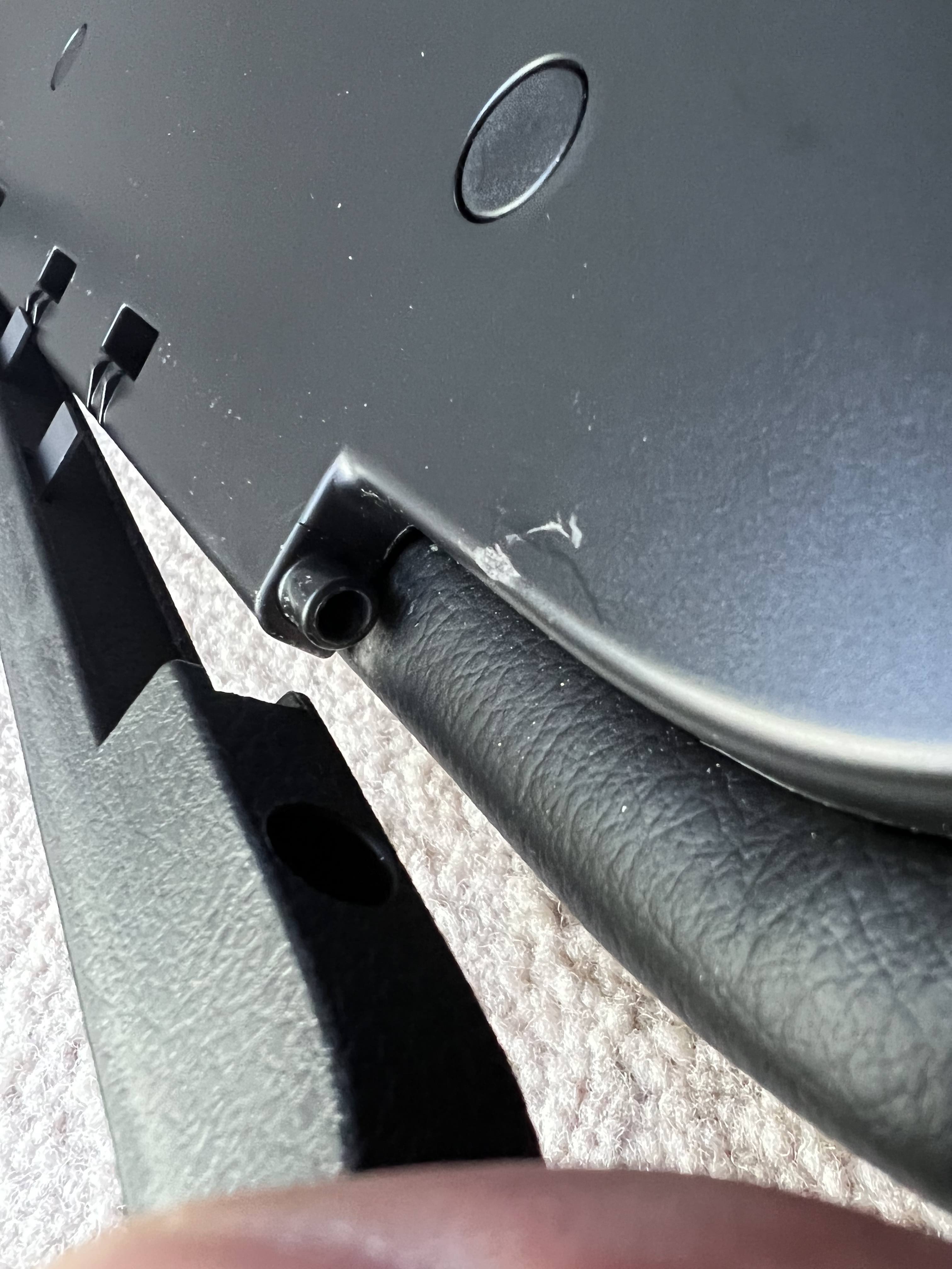

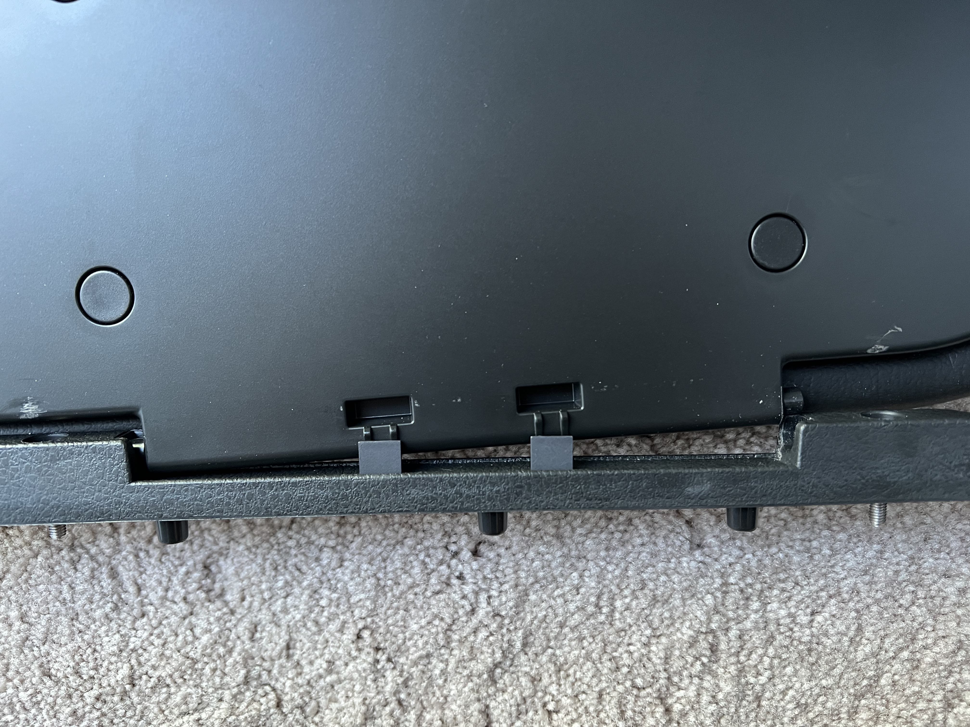

Hello - I just bought a brand new Toyota armrest to replace my 8 year old broken one. Installation was a breeze since the holes were already drilled for the old armrest. I have noticed over the past few weeks that every time I open the arm rest, the rear "hinge" pops out of its guide slot. Am I missing a part? Is there something that is supposed to keep the rear hinge captive like the front hinge? I can push it back in place while I close it, but it pops out every single time I open it. The mounting hardware is barely snug, so I don't believe it's warped or anything.

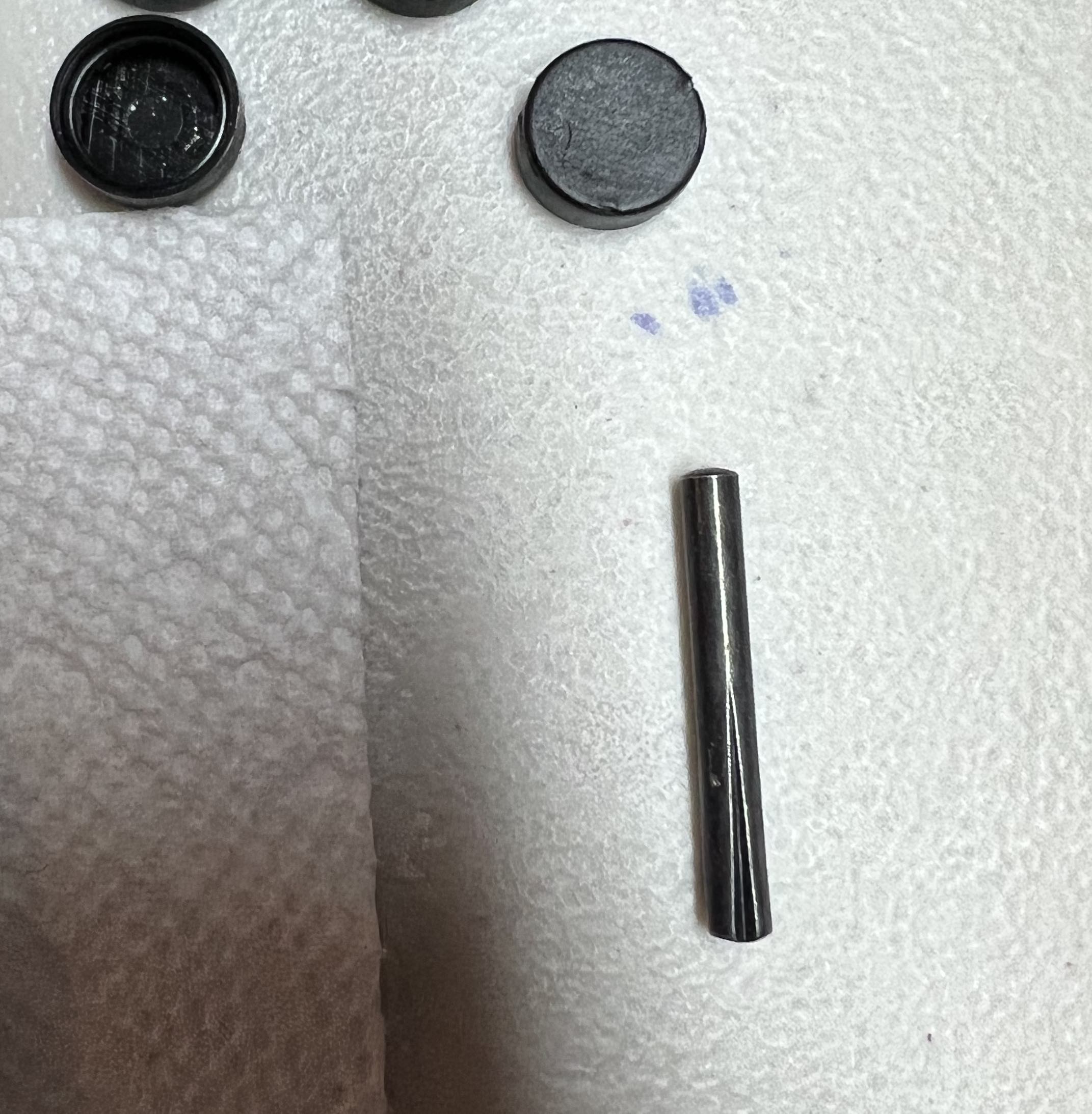

There's supposed to be some metal studs that poke out from the plastic part that hinges the two pieces together on both ends, they may have been retracted into the plastic itself.
I had this happened to me before... The solution is to take those circular covers off and undo the torq screws and push the studs back out. I then used CRAZY Glue to glue them back in place so they will NEVER retract again.

Thank you so much! I opened the top and found the loose stud unattached to anything. I put it back in place and added a few drops of super glue to keep it in place (added a few drops to the front stud too). Great solution. Thank you for your reply!
