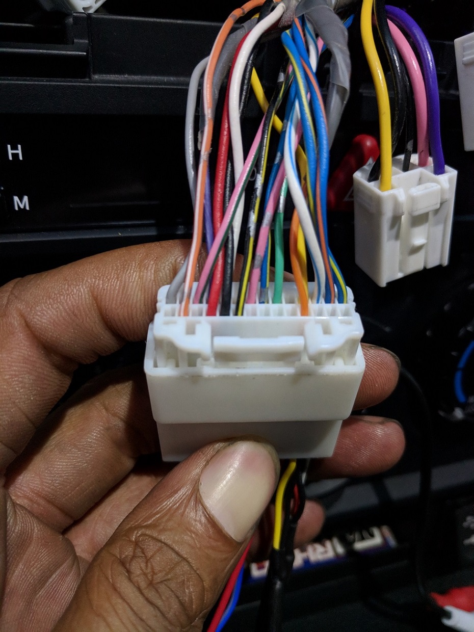

Solved: Just installed a Joying px5 Head unit in my 2015 FRS. I had the base touch screen stereo from the factory. A few years back I installed a Kenwood HU which worked great, zero install issues, but then I switched back to stock for a bit and now I have a joying Android 8.0 installed. It looks great and works smoothly, BUT THERES NO DAMN SOUND AT ALL. I’m 100% certain I have the speaker wires hooked up correctly, as well as I’ve fiddled with the Amp Turn on wire (brown wire in the 10-pin) but I just can’t get any sound at all, no door speakers and no dash or rear speakers. What am I doing wrong? Or did I get a bunk HU?
SKU: JY-UO139P4D
edit: Might be worth adding I’m using the metra 1987-up Toyota Harness(SKU: 70-1761) as recommended by the dingus at Visions Electronics, I double checked the wiring to the factory diagram as well as the Joying diagram and everything SHOULD be Hunky-Dory, but there’s no sound. I’ll double check the stereo output with a spare speaker I have laying around later.
here are some potatoe pics of the head unit and wiring.
Edit again: turns out im ruhtarded and you can't use this particular head unit with an external amp (don't ask it makes no sense to me either, prob something to do with the factory amp needing an analogue signal or something along those lines, don't really know) so i'm working with Joying to get a 9" unit that DOES NOT have the digital amp built in, currently they only offer that in 10.1" and 8" sizes, trying to see if a 9" option is available.
Final edit: joying is exchanging my Digitally amplified 9" unit for one that is not amplified. Leaving my blunder here for posterity and to hopefully be helpful for others.
